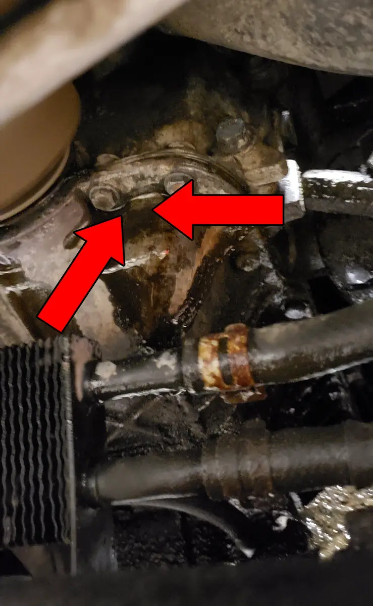

Checked my motor oil again and it was surprisingly half way between min and max. 3 days ago I checked it and it was just over the max line. So it's oil I am losing, not coolant. It looks like K seal has already sealed my coolant leak from wherever it was coming from. So that's the good news.
I put more oil back in the truck.
This is what i don't get. I just took it for another long drive on the highway, got it fully hot and glanced under the truck after and the leak is a lot slower. Still leaking but it's like 80% improved compared to the first day. If K seal is for coolant, and Im leaking oil, then how is my oil leak slowing down too?
It looks like K seal will help oil leaks too.
I have a small crankseal leak - some oil changes it goes away. Weird, I wouldn't lose sleep over it.Depends which route I decide to go.
The oil pan has two small hairline cracks on the front left side. This is the worst of the oil leaks. This is caused from that idiot mechanic overtorquing the bolts back on and cracked the oil pan. Can't buy a new one but was told you can seal it with silicone or sealant. Mech says it should hold up and is much cheaper. Mech also says I would likely need a new harmonic balancer.
The crankshaft seal is also slowly leaking.
The lower intake manifold gasket is also starting to slowly leak. This one I could get away with just leaving as is.
Radiator has a small crack on the side and is a bit swollen. There is also a small tiny crack in the plastic neck where you pour coolant. But I'm not too worried about this because the K seal will seal it if it already hasn't (seems like it has). So I wouldn't bother with replacing the rad.
Was quoted $719cdn to replace the crankseal, harmonic balancer, including labour.
$135 to reseal the oil pan and gasket area. I may just get him to reseal the oil pan and gasket area to start.
The crank seal is very little coming out and I think over time it's okay to have a leak from there, as in not a safety issue.
I'm also looking into any addictives I could put in for this leak. If there was such a thing as k-Seal but for oil...

Harmonic balancer is 95% of the work for a crank seal. You would have to be crazy not to do both. Sometimes a special "service" sleeve has to be installed on the surface where the seal seals. The mechanic will know.

JB weld is fine for the oil pan. clean it up well. We aren't looking for a showcar here. Just keep an eye on the oil. Some brand new cars burn oil.
