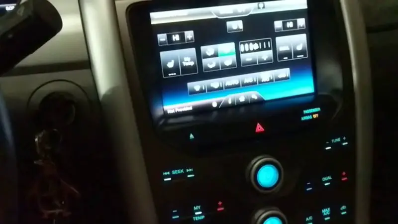

All the air comes out the dash vents. Regardless of what I press it always just comes out the dash vents. I can feel a little air on the floor, none at the window vents. I have read somewhere on line that it is most likely is a control module up under the dash on the drivers side somewhere? Does anyone have more information about this? I know it is not the blend door, I have equal heat/air on both sides. Just can't adjust where the air comes out at. Hoping someone can help me with more info and the procedure to replace this module. I already have a feeling it is not and easy replacement.
I have a 2014 XLT, My sync tech touch screen control.
Still sounds like a blend door since there are 4 of them. Look at c236 of the diagram posted above.
You have fresh/recirc air, right cold/hot, left cold/hot and direction controls.
