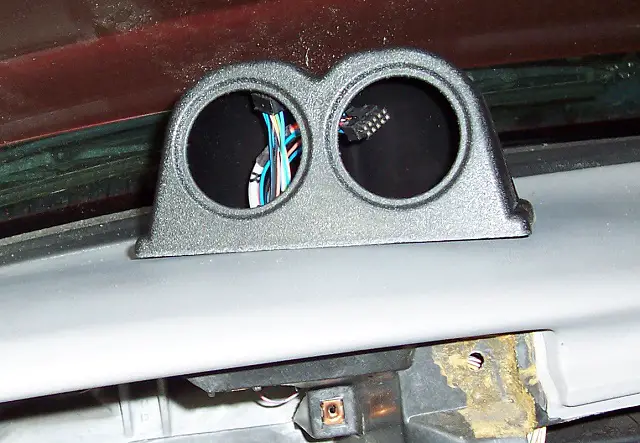

At some point during the installation of my M90 supercharger my AutoMeter 5978 wideband air/fuel ratio (AFR) meter quit working properly. At first I thought the O2 sensor had gone bad since the meter was indicating the maximum AFR of 16:1. I purchased a replacement sensor on ebay that included the entire wiring harness from the sensor to the meter. Unfortunately, replacing the O2 sensor did not fix the problem. I tested all of the wires from connector to connector for continuity and shorts and found no problems so I purchased another complete system. Then I replaced the old meter with the new meter and had the same symptoms. I concluded that I had damaged the wiring when installing the boost gauge, oil pressure gauge, electronic fuel pressure regulator or throttle cable. I decided to start over from scratch assuming I had two good meters, two good wiring harnesses and three good wideband O2 sensors. I purchased a dash mount two gauge pod to house left and right bank meters and removed the dash mount one gauge pod containing the oil pressure gauge which will be moved to the pillar pod where the left bank AFR meter was.

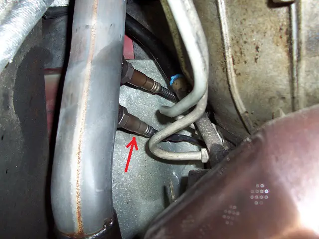

When my high flow exhaust system was installed I had the shop install a bung for a wideband sensor on both banks. The left bank wideband O2 sensor is shown below - downstream of the pre-cat narrowband O2 sensor.
That was done in June 2013 and there has been a plug in the right bank ever since which did not want to come out. I have a set of hex head sockets but there was no room for a drive to use them. The only thing that would fit was a short allen wrench. Every day I soaked the plug with PB Blaster and "tapped" the end of the allen wrench several times with a length of pipe struck by my 4 lb hand sledge. On the third day it broke loose and I was able to install the new wideband sensor identified below.

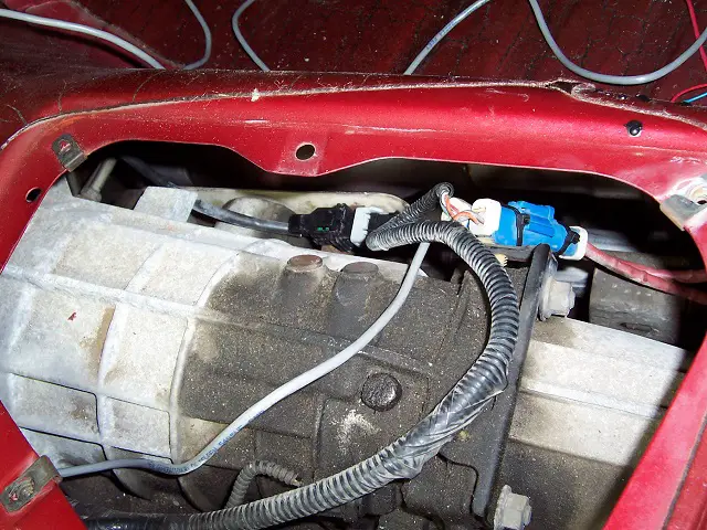

The post-cat O2 sensors were replaced with short cable units by a previous owner. The right one did not reach the mounting bracket so I tie wrapped it next to the left one and attached the wideband connector to the unused mounting bracket.

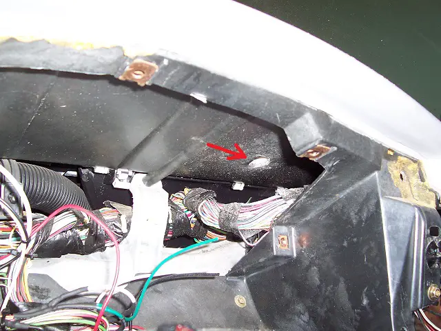

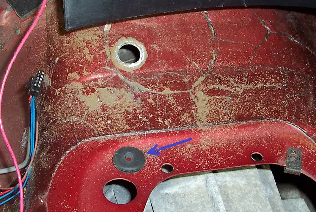

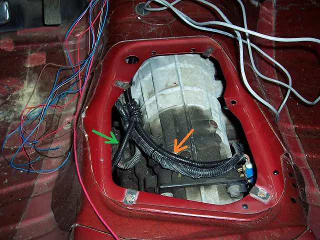

I drilled a 3/4 inch diameter hole in the transmission tunnel between the reinforcement ridges to allow pass thru of the smaller connector that goes to the meter.

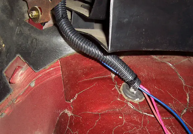

I found a grommet that fit the hole and enlarged the center with a file for the two gray cables. After passing the cables thru the hole and installing the grommet I installed wire looms to protect the cables.

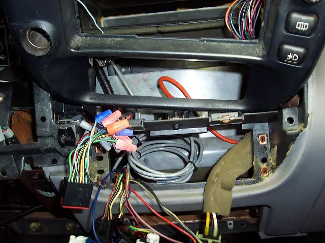

The various colored wires on the left are for power, datalogging and peak AFR detection.
