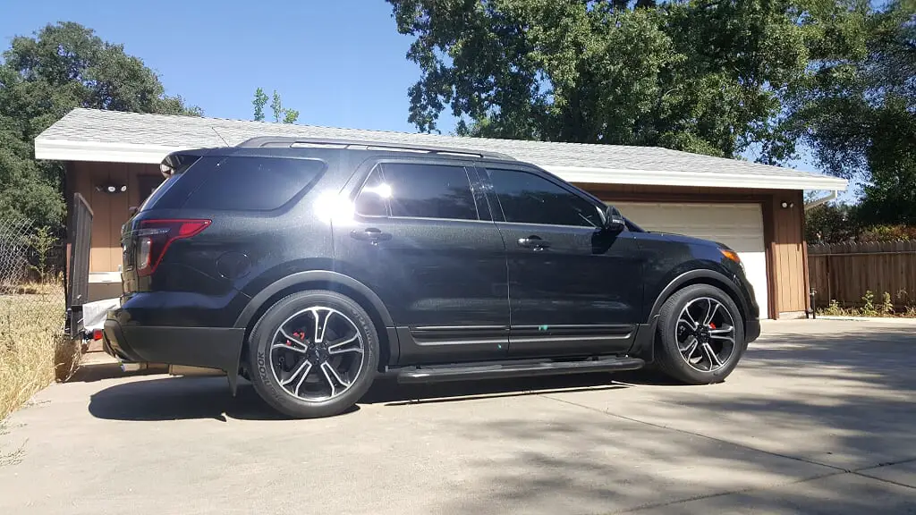

OEM Ford Explorer Sport wheel and tire specifications:
  • Wheel size: 20" x 9" with 44mm offset (with 25mm spacer - effective offset of 19mm)
  • Color: Contrast cut black with silver
  • Centerbore size: 63.4mm
  • Tire size: Hankook Optimo H426 255/50-R20
  • Wheel and tire combination weight: ~72lbs.

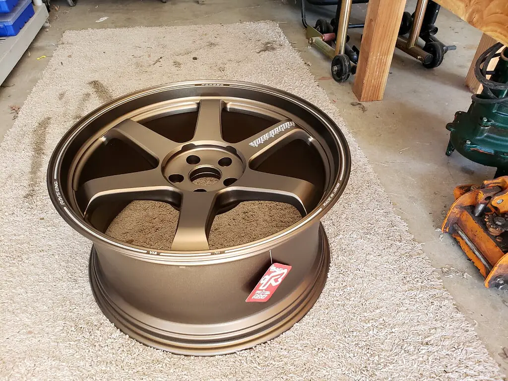

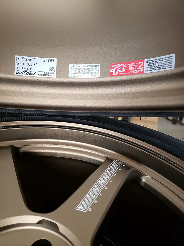

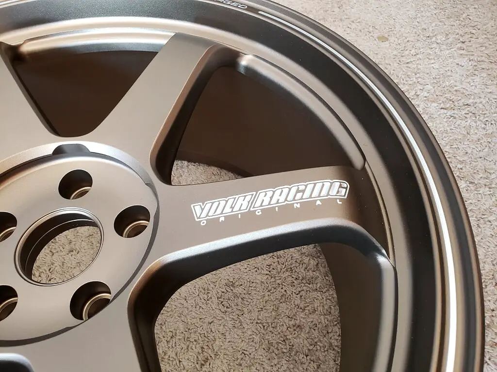

I ended up picking some Volk Racing TE-37 Ultra wheels as they are some of the lightest 20" wheels on the market. And instead of using spacers, I decided to put some additional offset to make up for the wider stance I was looking for.
Volk Racing TE-37 Ultra wheel and tire specifications:
  • Wheel size: 20" x 10" with 30mm offset (with 6mm spacer - effective offset of 24mm)
  • Color: Dark bronze
  • Hub size: 73mm
  • Tire size: Hankook Ventus ST RH06 275/45-R20
  • Wheel and tire combination weight: ~58lbs.
I picked everything up from Vivid Racing. It would take a few weeks to get as the wheels had to come directly from Japan. I also ordered some TPMS sensors from them so that I could mount the new stuff and be rolling, and leave the OEM wheels as is, in case I wanted to throw them on for something.
Got some goodies!!!

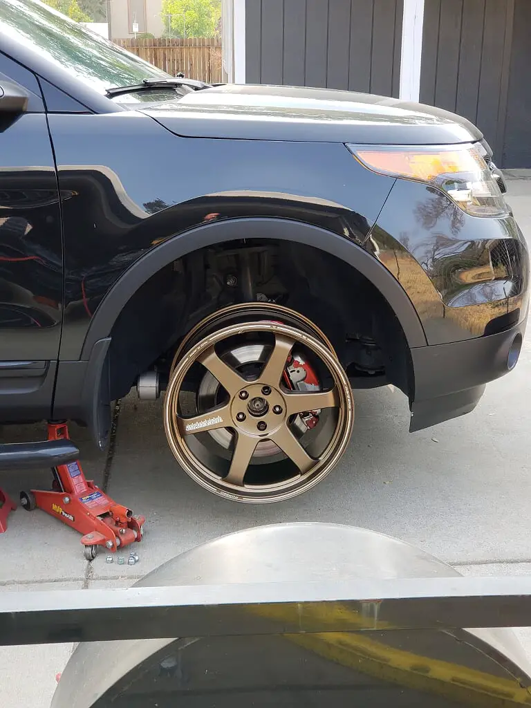

Couldn't wait to mock them up, LOL:
It's very important when getting aftermarket wheels that you don't forget the hub centering. In this case, Vivid provided the centering rings free of charge. But if you need to get yourself some, they aren't usually very expensive. You just need to find out your OEM centerbore and aftermarket hub sizes.

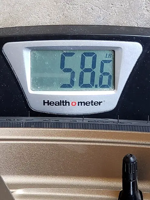

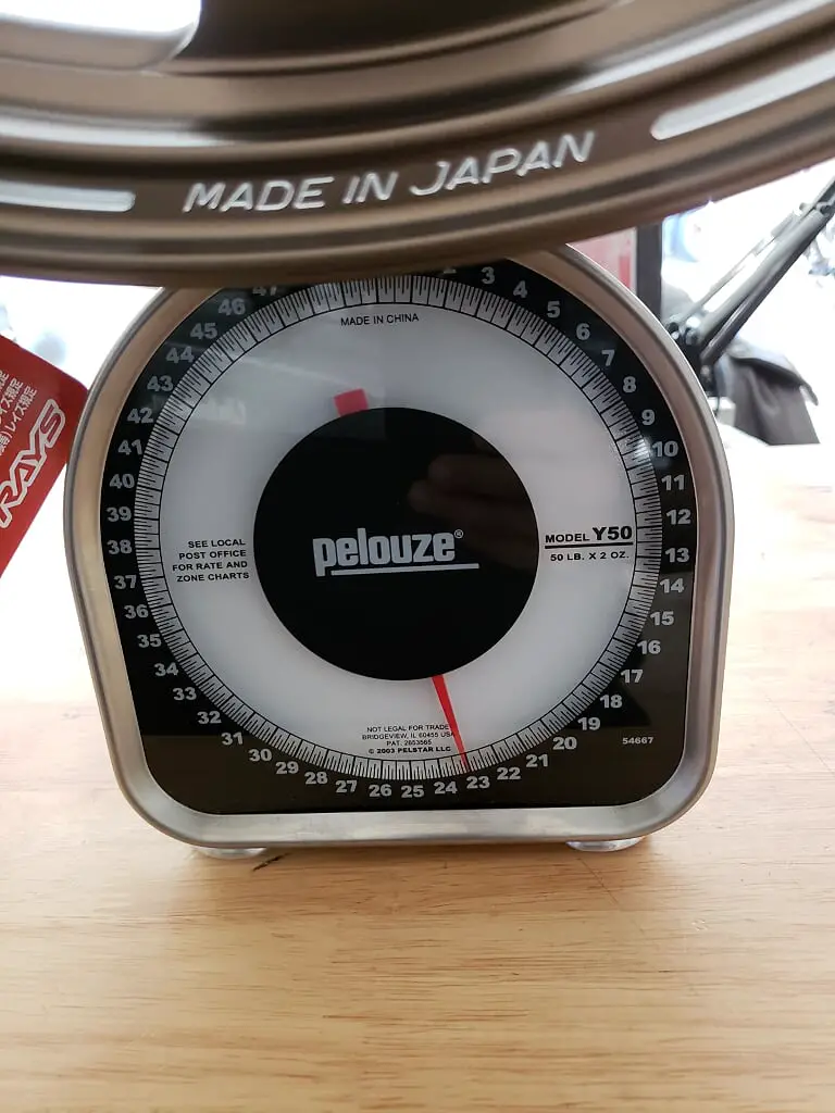

Wheel weight:

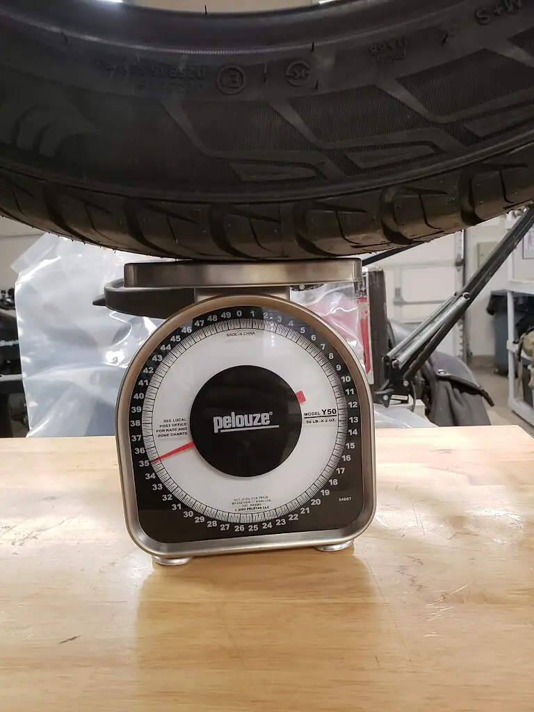

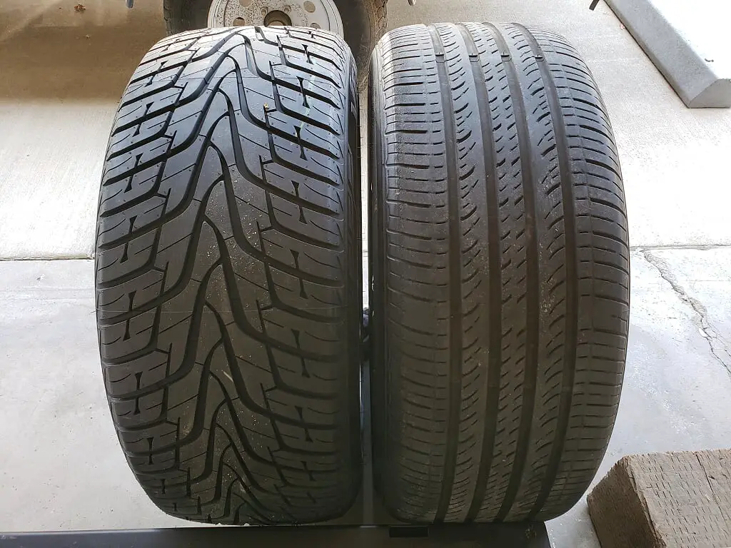

Tire weight:
Comparing tires:
Yeah, they are the real deal...LOL.

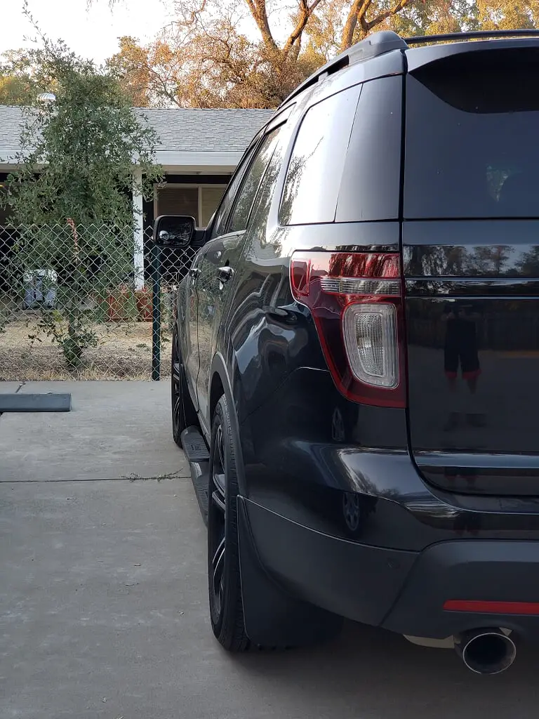

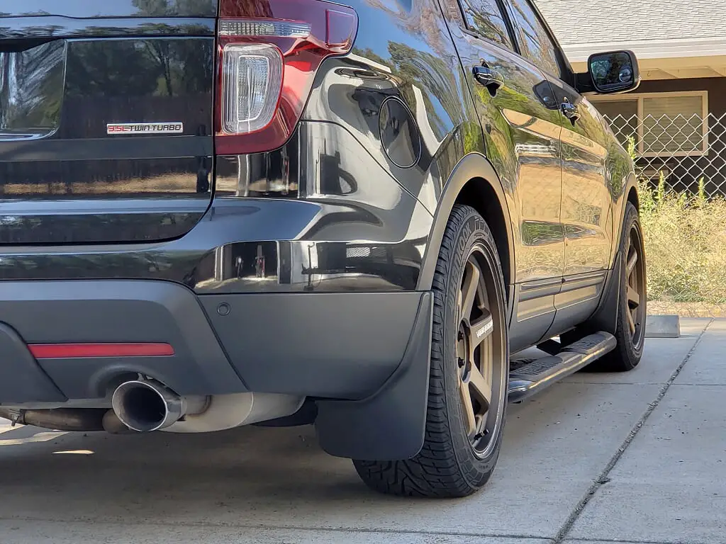

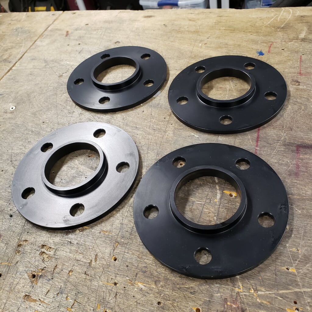

When I finally got the wheels mounted, in all honesty, I was still a bit dissatisfied with the offset. Loved the wheels, just didn't get the "stance" I was after. So I ended up having some 6mm spacers custom made by Motorsport Tech. I had them have those spacers have the hub centering ring machined as part of the body of the spacer. That made the installation of the hub centering rings unnecessary. I took them to a local anodizer and they hard-anodized them black so that they wouldn't be easily seen.

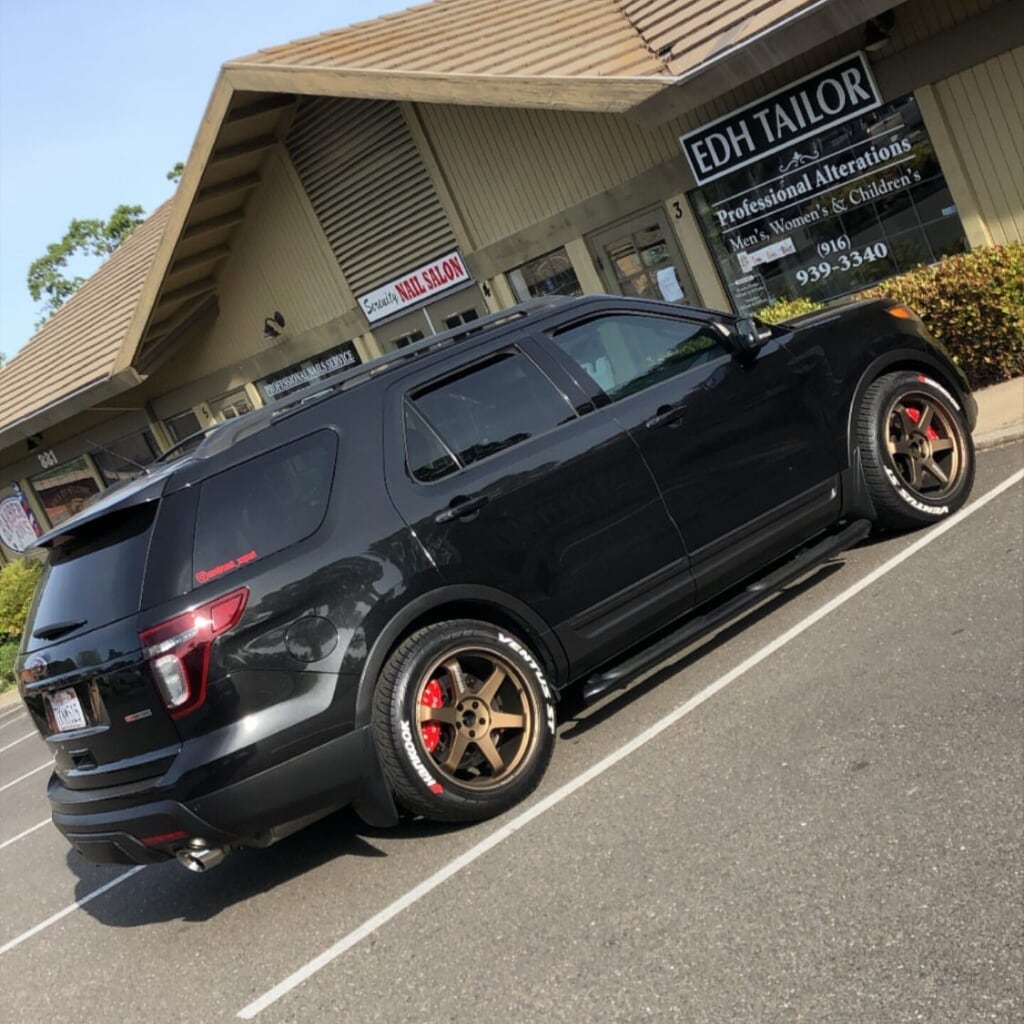

A few months later, I ended up putting some Tire Stickers on as I was liking how they looked on other cars. I was apprehensive at first, but it ended up growing on me:
(photo courtesy of AutoHo
Weight Reduction Running Tally: ~104.0 lbs

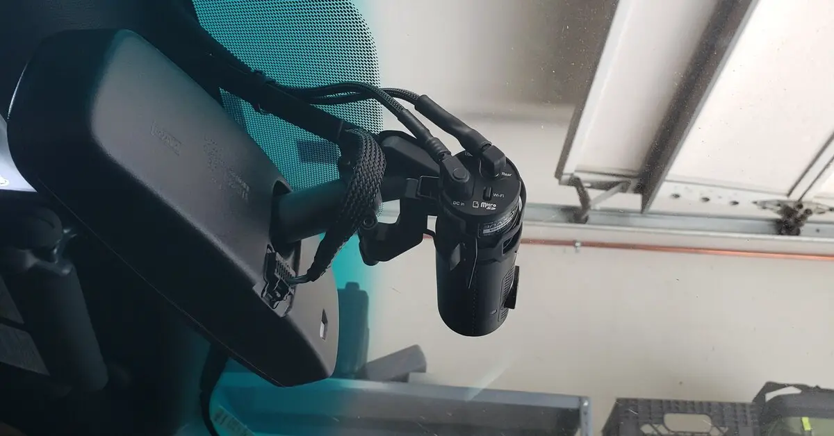

I've been really slow-playing on my writeups. I still have 20 different writeups in various stages of a DRAFT that I need to finish. Here is one of those 20. This one's actually been installed for about 6 month now. I'm finally getting done with the writeup. Apologies, everyone...
BlackVue DR900X-2CH UHD 4K DashCam
Personal Blog Link: I see what you did there! Front AND back!

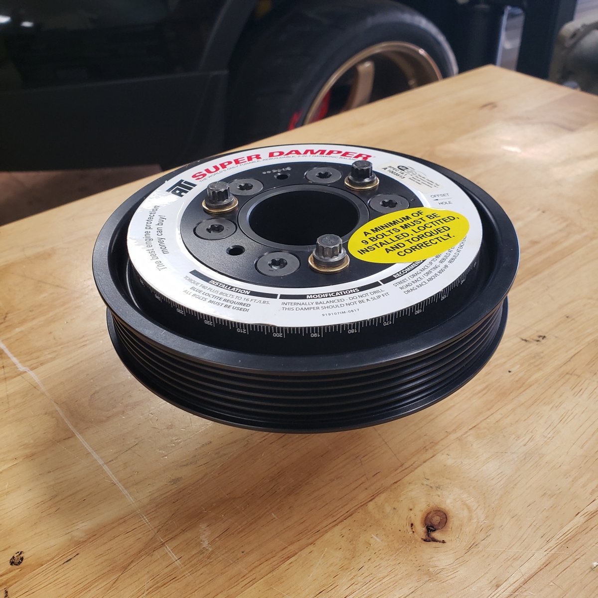

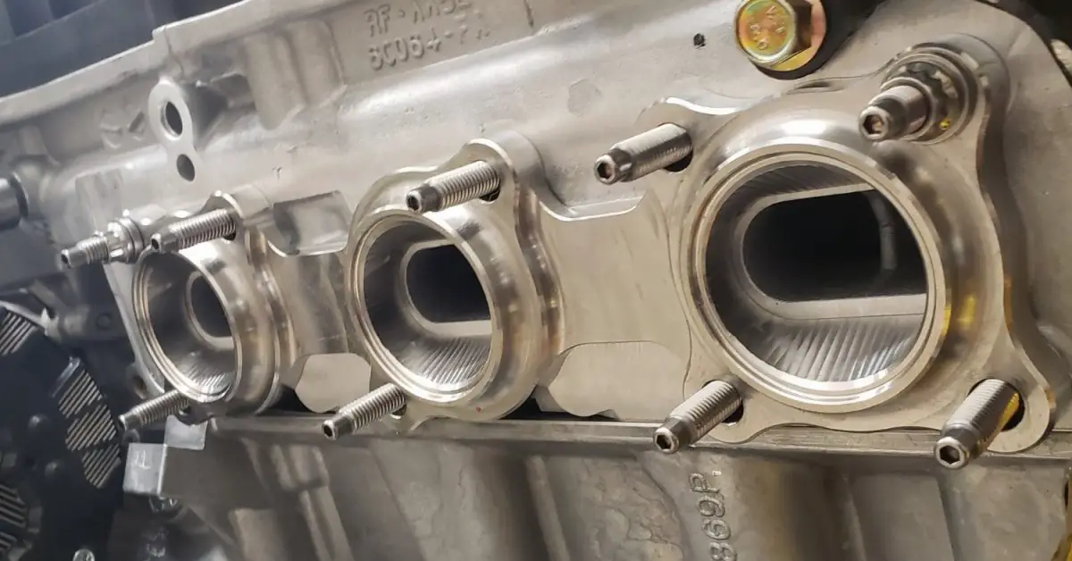

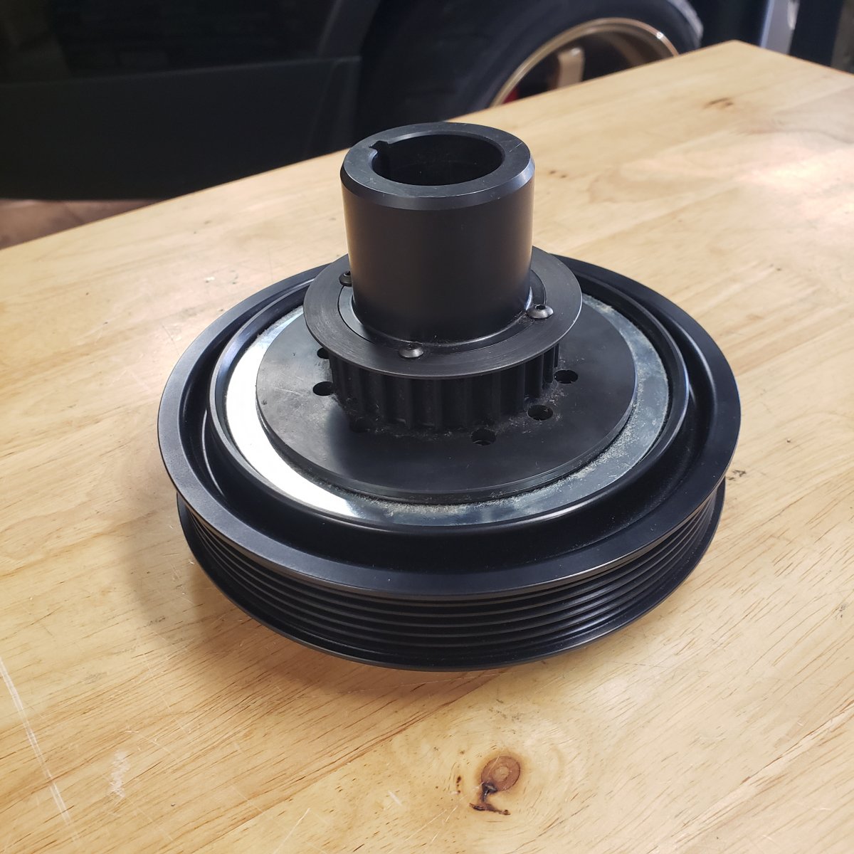

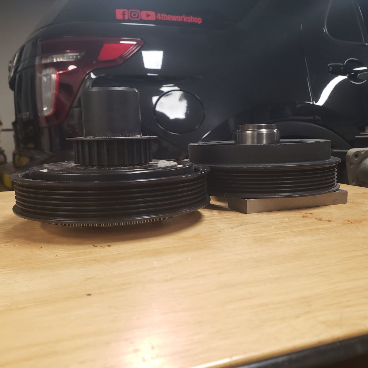

Sometimes I really hate myself. I start so many projects and don't finish them before starting another. Well, add this to my long list of projects. Found an ATI pulley that fits, as well as an ARP crank bolt, but the pulley will need some pretty decent hub modification, and the flat washer will need to be turned down a bit...challenge accepted.
You ever get that custom short block installed yet? Curious why you are building it. A stroker? Did you bend a rod? Also what hp increase are you thinking with new manifolds? Do you think the stock exhaust manifolds are limiting you? You are pioneering the way for 5th gen Explorers and I enjoy reading your posts.
Hey there, my bad for responding so late. I'm not on here as often, I spend more time on the FB groups and the SHO forum.
Anyway, I'm building it "just cuz" lol. I'm gonna push this to the limit and just see where it takes me. Taking a lot longer than I anticipated but still moving along. It isn't in the car yet as I'm finishing up the custom manifolds and have a trick ATI balancer I'm trying to make work.
