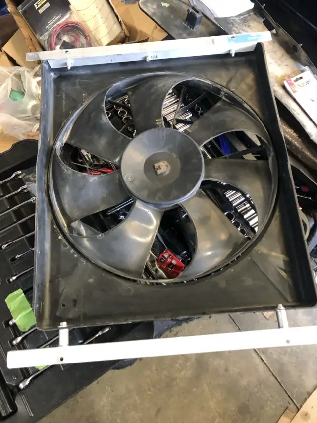

Just finished installing the Taurus electric fan into my 2002 Explorer. Virtually no cutting of the original fan shrouds (at least the upper other than for clearance for a wire harness), and keeps a stock, clean look.
Just need to get some aluminum 90 degree brackets and cut them to fit on the ends of the fan. (The fan will be mounted so the factory warning label is on the left toward the driver's side.) I had to cut off the mounting ears, and drilled new holes into the Taurus' fan shroud to pass through bolts and nylock nuts to hold the top bracket. The bottom bracket needed 1" ferrules and a couple of washers (and 45 mm long bolts) to reach the bottom of the radiator. 4 bolts hold the electric fan in place.

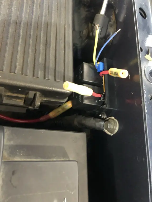

I used the Delta Current Control (DCcontrols.com) 2SPA fan controller which comes with its own temperature sensor. Super clean install and I drilled a couple of holes near the underhood fuse box and mounted it there.

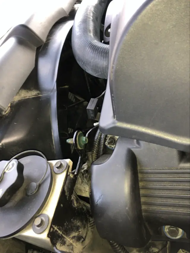

The original top shroud fits fine without issue. Bottom shroud needs a little clearancing of the Taurus fan shroud's ribs (or cutting a hole in the lower fan shroud... I prefer the former and will be doing that later.) Moves a lot of air, looks stock, and the engine is more responsive.
