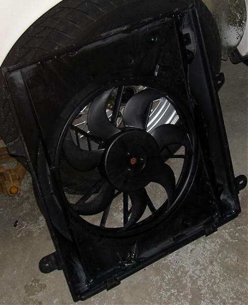

Measure the thickness of the motor, the basic distance from the back side of the fan motor, to the front fan blade shroud edge. The entire rest of the shroud can be cut up, gutted, etc. You only need the fan motor, blade, and the shroud which encloses those. The rest is simple to whittle away and epoxy to the factory Explorer shroud.
