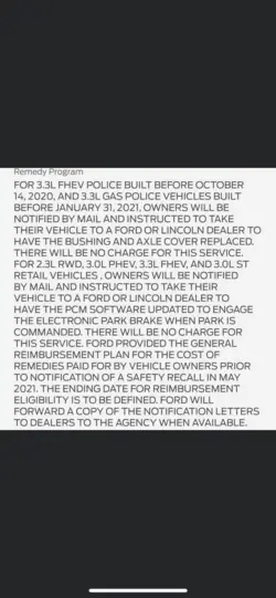

According to Ford, there is no intention to replace/add an additional bolt until it actually breaks. They will be proactively fixing the actual issue for Police Inteceptors only but not until later this year.

EDIT: Since merging the other thread on this topic, it appears it is a new software "fix".
Peter
I can confirm the PCM update is available. :D
I’m not a fan because I hate having to press the accelerator or the button to make my car go backwards or roll out of a parking space.
I suppose I will get used to it, but it’s less than ideal.
Im curious as to why Police Interceptors get updated driveshafts and we get the software. Police or citizen, we all put our vehicles in park the same way.

It has to do with the extra torque put on the drive train. Police obviously use their vehicles more aggressively with frequent hard acceleration. One bolt would most likely fracture under those conditions. And Ford is just doing a CYA to avoid having to recall so many vehicles to replace those subframes. The fix doesn't fix anything - it's just a band aid.

Immediately upon getting my Explorer back after nearly 4 weeks I noticed that every time I shifted into park the parking brake was automatically applied.
After a short discussion with the dealer it was learned that this new transmission had the “recall fix” applied.
The parking brake will stay on until you shift into gear and either press the button or gas pedal.
I expect this change will becoming to all recalled Explorers in the next few months.
