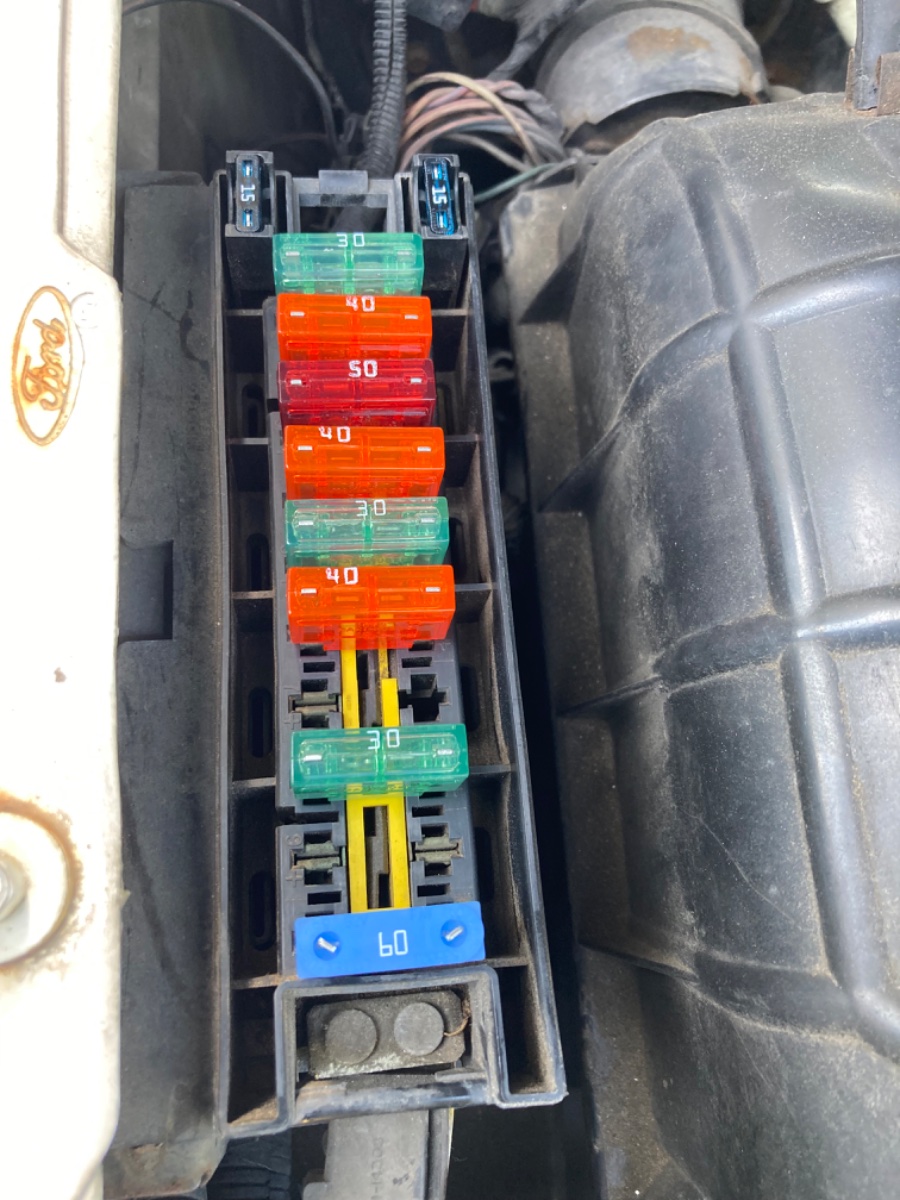

i HAVE A 91 EXPLORER, THE 40 AMP FUSE FOR THE "ELEC. SHIFT" IS MISSING.WHAT IS THE "ELEC. SHIFT"? AND IS IT IMPORTANT TO HAVE A FUSE IN THE SLOT?
The electric shift fuse is for the electric shift motor on the transfer case. It is what shifts the t-case from 2 wheel drive, to 4 wheel drive, and into low range. So yes its important if you want to use 4x4.

Where can I find this thread. I saw same thing in my fuse box. 40amp is missing
Or maybe the truck is rwd
Or manual shift 4wd
No fuse from the factory on that truck then
I swapped out the old fuses for new ones today and left it empty

Yes. Only name brand fuses. All are Bussman with the exception of the 60amp which is littelfuse
