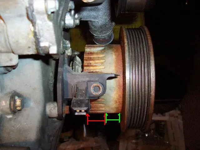

If the "cap" you're referring to is a distributor cap then you won't find one because your engine has no distributor. It has an electronic ignition system and the timing is controlled by the PCM. The crankshaft position sensor is located next to the crankshaft harmonic balancer and is subjected to road grime as well as slush. I suggest that you clean it by disconnecting/reconnecting a few times. It is accessible from under the engine.

Okay I had a chance to stick my head under the truck and found the sensor. I wasn't able to get to it, as there were a number of objects in the way. It does look to be in okay shape, not rotted or cover in crap. I didn't get it off, so I didn't inspect it to that point. I did though find a leaking lower rad hose and a oil leak coming from the front right axle....lol That's a whole new post though. I sprayed the connector with wd 40 and road tested it, no improvement. The truck comes off the road once winter is over, (hopefully soon) and I'll look at it then. Just curious if I should check the fuel filter, and also see if the voltage to the distributor pack is proper, I'm thinking the ignition could be crapping out.
