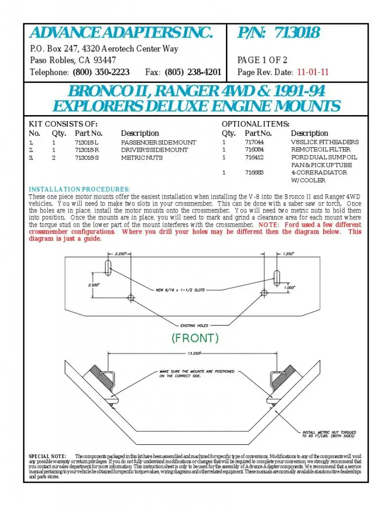

Well mine are from advanced adaptors - I like the mounts there well built - one piece though - and it's calling to drill a hole 2.5" back and 2.25 up on passenger side and 1" up and 1.25 back on driver side from existing holes - but doesn't specify which hole - should I go based on the hole for the stud from the v6 perch?
They are most likely using the factory holes as the reference.
If you lower the engine in with the mounts attached to it does it look like the dimensions they gave you make sense?
Driver side yes - passenger side no - there dimension up put the hole up in the air but if u go up 1" like the driver side it's pretty close - they say slot the new holes forward and back but were thinking they need to be slotted down since the mounts have a stud on them about 1.25" long the motor will want to lower it self into the holes so we figured slot them down so the motor mounts will fall flush with the cross member

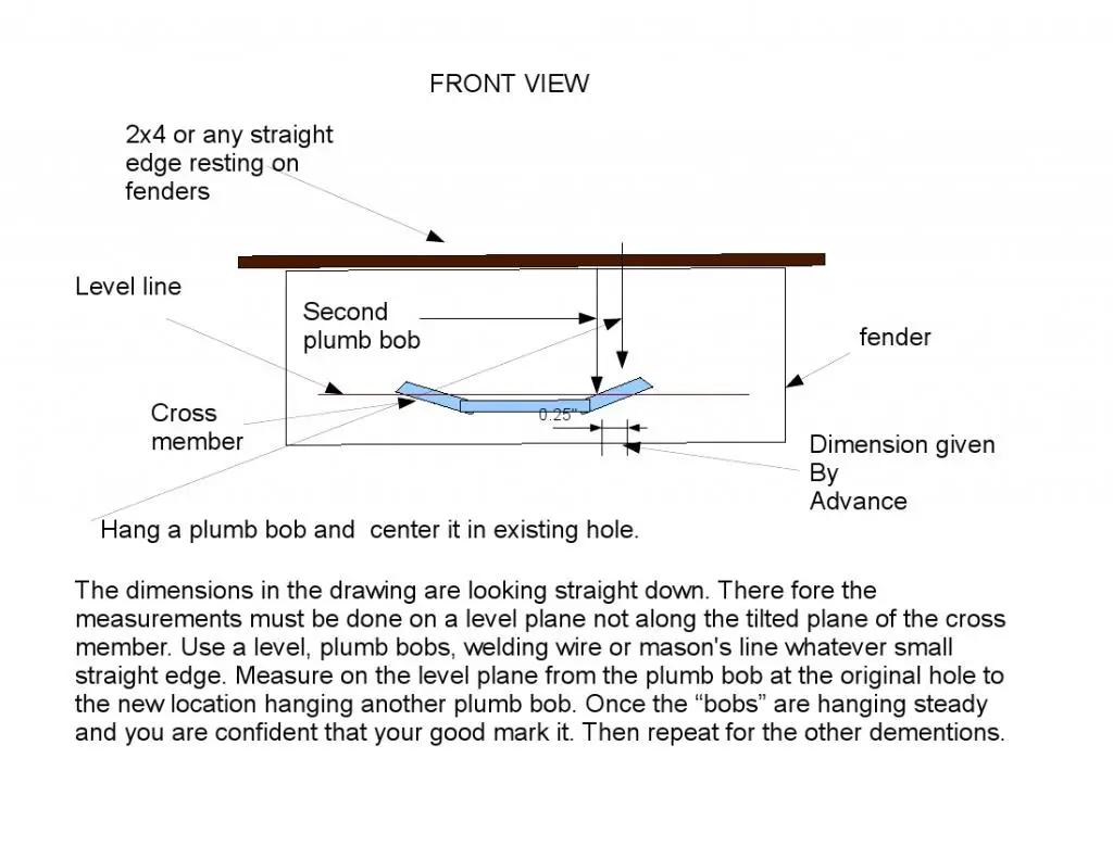

OK I got some visuals.
Hope this helps.

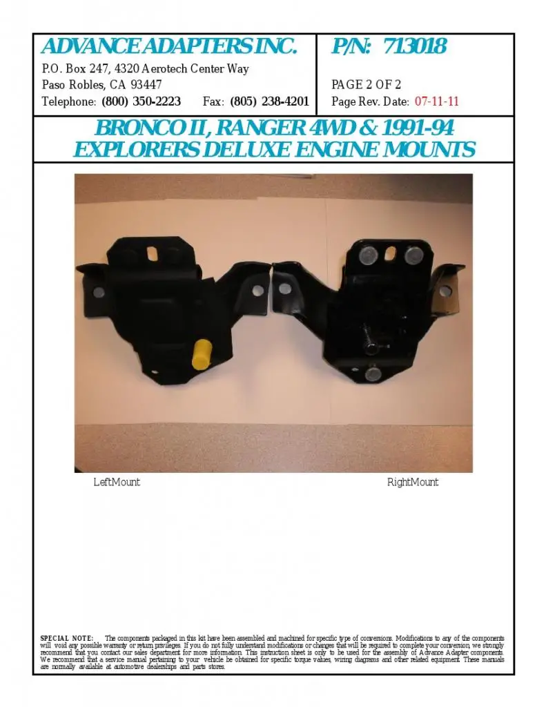

Your Advance Adaptors mounts: Yes?
The directions:
The Plan: Drawing is lame but it should do, I hope :thumbsup:
So three plumb bobs, the starting point, measure "out", Measure to rear. Mark it.
The Studs would then go in the new slots. Giving you some adjustment room forward and aft.
Then the mounts remain on the cross member. Lower the engine in and finagle the bolts up into the block. Nice!
