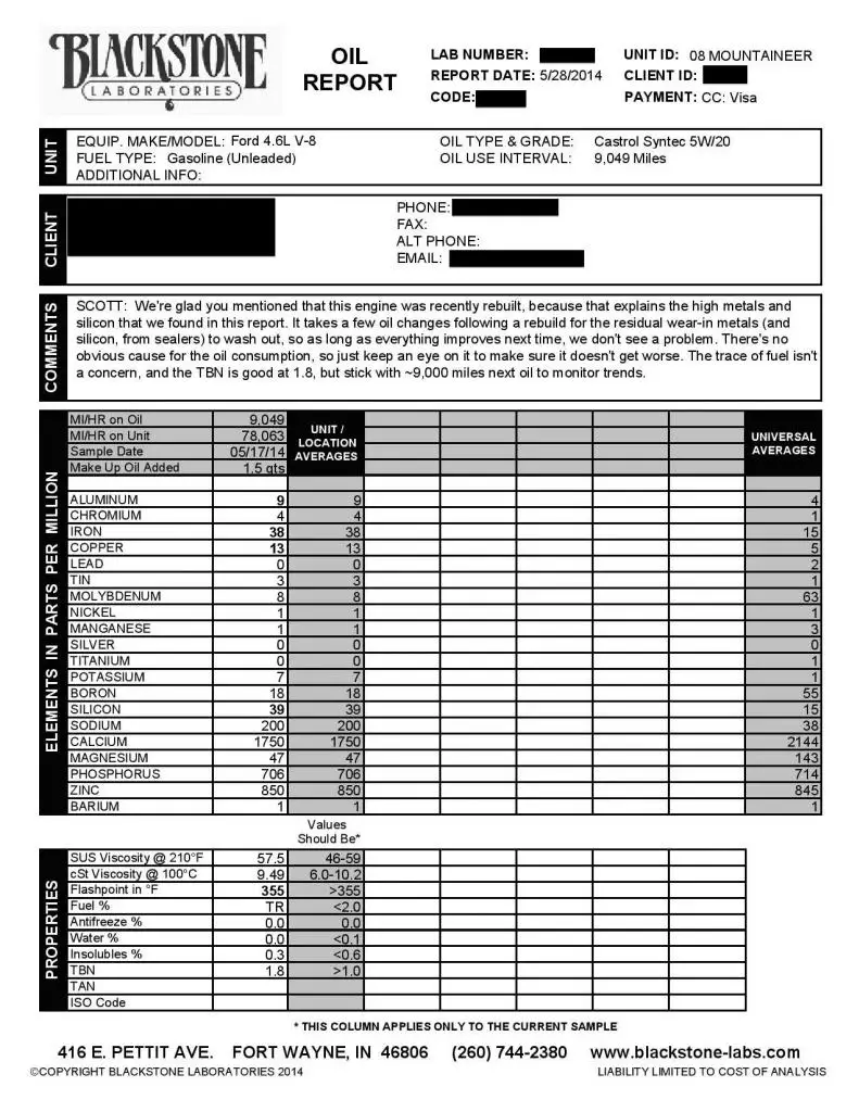

On the oil use, I do all the oil changes so I know that the engine didn't use very much oil between changes. If it did, it was still on the upper end of the dip stick so I didn't notice. Because like you said and I agree, they all use oil but it definitely didn't use 1.5 quarts after 5K miles. I would be fine with some use but not all the way to the bottom of the stick, especially since it seems like the use may be increasing.
Thanks for the information, seems like you're dead on with the leakdown test. Hopefully that'll find the issue. I really, hope they're honest with the results. Short of me sitting there while they're doing the tests I'm not sure how to make sure they don't fudge numbers. I just may ask to do that!
