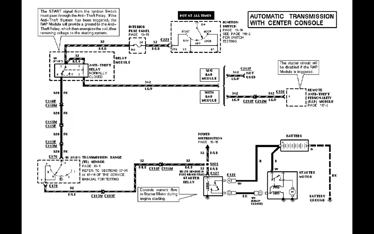

See attached. Check the fuse first
It probably the power PCM relay. See attached

Pcm relay for sure
