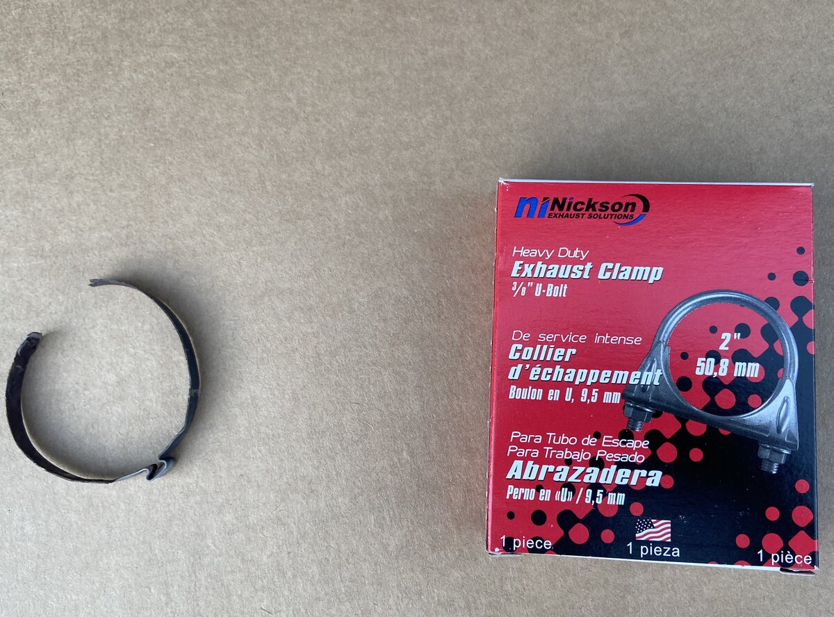

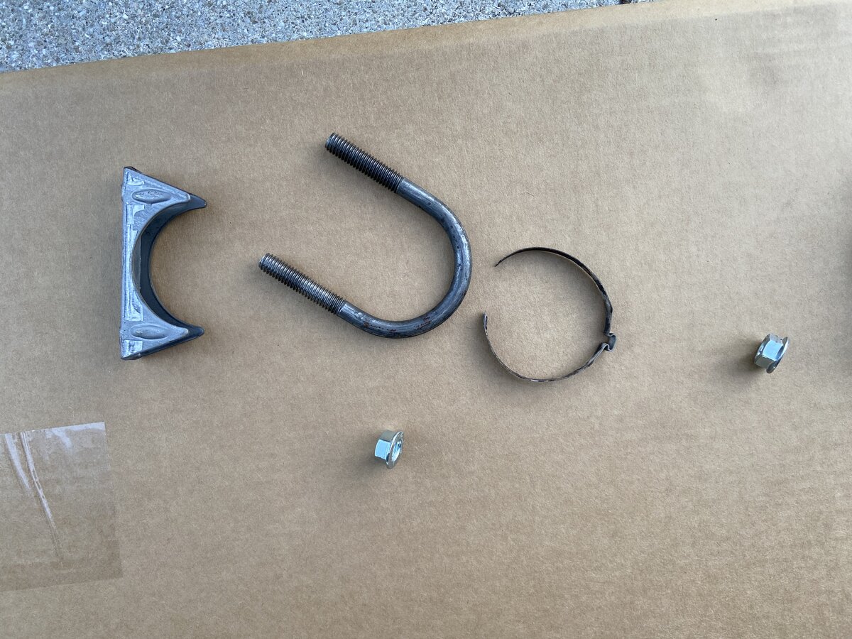

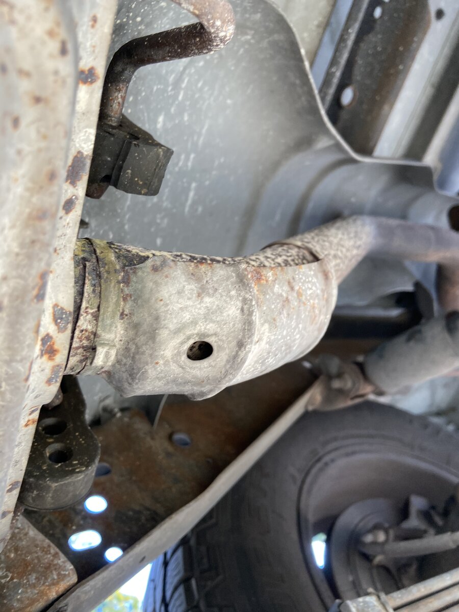

I had a rattle when in drive for the past 6 months and I couldn’t find the source of it. I hit all the heat shields on the exhaust but couldn’t reproduce the sound. But I missed one.
After 20 years the clamp behind the muffler finally broke.

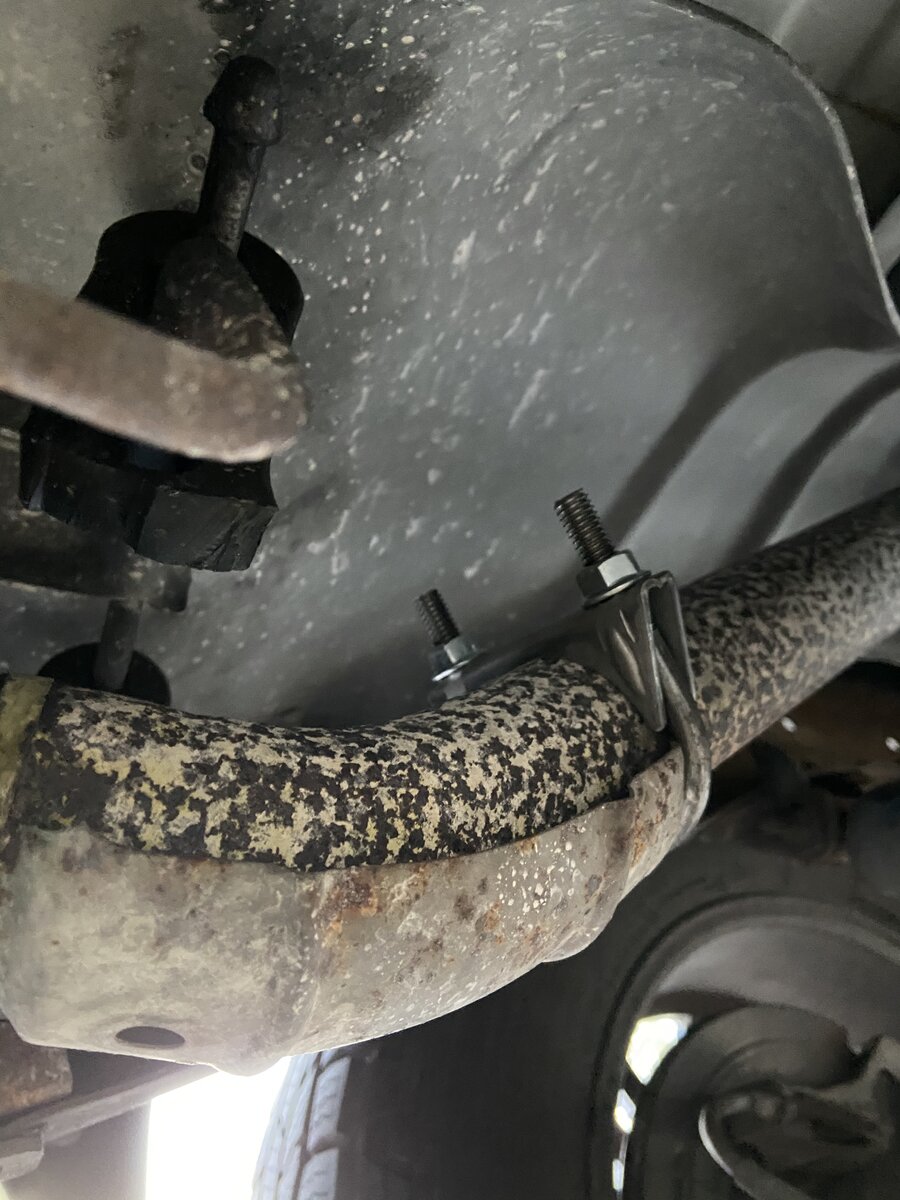

I replaced it with a 2” clamp.
I had to mount if upside down so it could fit around the shield correctly. No more annoying rattle
