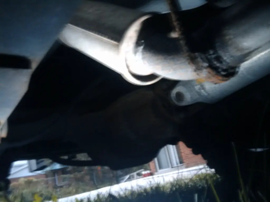

you don't even need to replace the muffler. When mine took a dump at 120k I cut it out and welded in a straight pipe. Sounds really good as there is the still the small resonator in the back by the axle hump.
