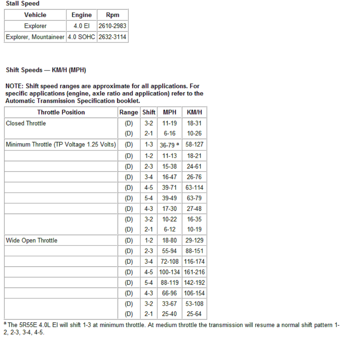

All right, that means my SOHC Explorer is capable of going 134mph. Damn, I knew it was fast, but cool, I wonder what the speed limiter is on these?
LOL, speed and SUV's shouldn't be discussed together very much. I have needed my SUV's for work since the 90's, but speed was never a need for any reason. I am working toward a performance SUV project, but the goal will never be to street race or see if I could keep up with some sports car. Whatever I've done to mine has been for better safety and reliability. Better braking and acceleration is a goal too, stock is not impressive. But that doesn't mean everyone is trying to get out on the interstate and drive 80mph, in a pack or commuting, or racing. I have yet to have my SUV's over 100mph enough to find a rev limiter, but I have felt it in my old 86 Crown Vic with the Mustang 302 and stock PCM I used(about 105mph).

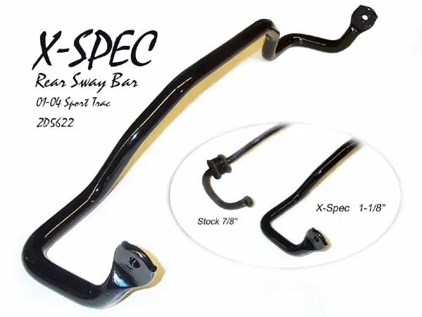

Good points Don. IIRC, two door Sports weren't equipped with the axle damper "fifth shock". Would love to see the OP find and install a larger REAR sway bar. Too bad the Explorer Express X-Spec, Addco 633, and Hellwig 7648 have all been discontinued. Made a HUGE handling difference on mine. Not just cornering, but at highway speeds or when windy. Best handling upgrade I've EVER done, nothing else comes close.
Guess you missed my earlier post above. Always upgrade the REAR sway bar first. (If you can find one).

...Would love to see the OP find and install a larger REAR sway bar. Too bad the Explorer Express X-Spec, Addco 633, and Hellwig 7648 have all been discontinued. Made a HUGE handling difference on mine. Not just cornering, but at highway speeds or when windy. Best handling upgrade I've EVER done, nothing else comes close.
That rear sway bar is the biggest item to upgrade for the safety of all 2nd gen Explorers and the later same rear suspension Sport Tracs etc. That one change is massive in improving the safety at any speed of these SUV's. The rear suspension of these with leaf springs, is very soft at lateral control. The whole back of the truck is swaying back and forth(not just the rolling around CG), because there is no lateral control device, the leafs and mounting shackles do that poorly. Anything that will reduce the body from moving independently of the tires in back, will help a bunch. The body "wraps up" as the truck corners, and "unwinds" as the weight shifts, and it's not well controlled. Roll overs happen for more than just the tall vehicle height and heavy weight. The suspension design has a lot to do with that issue. You can make it better.

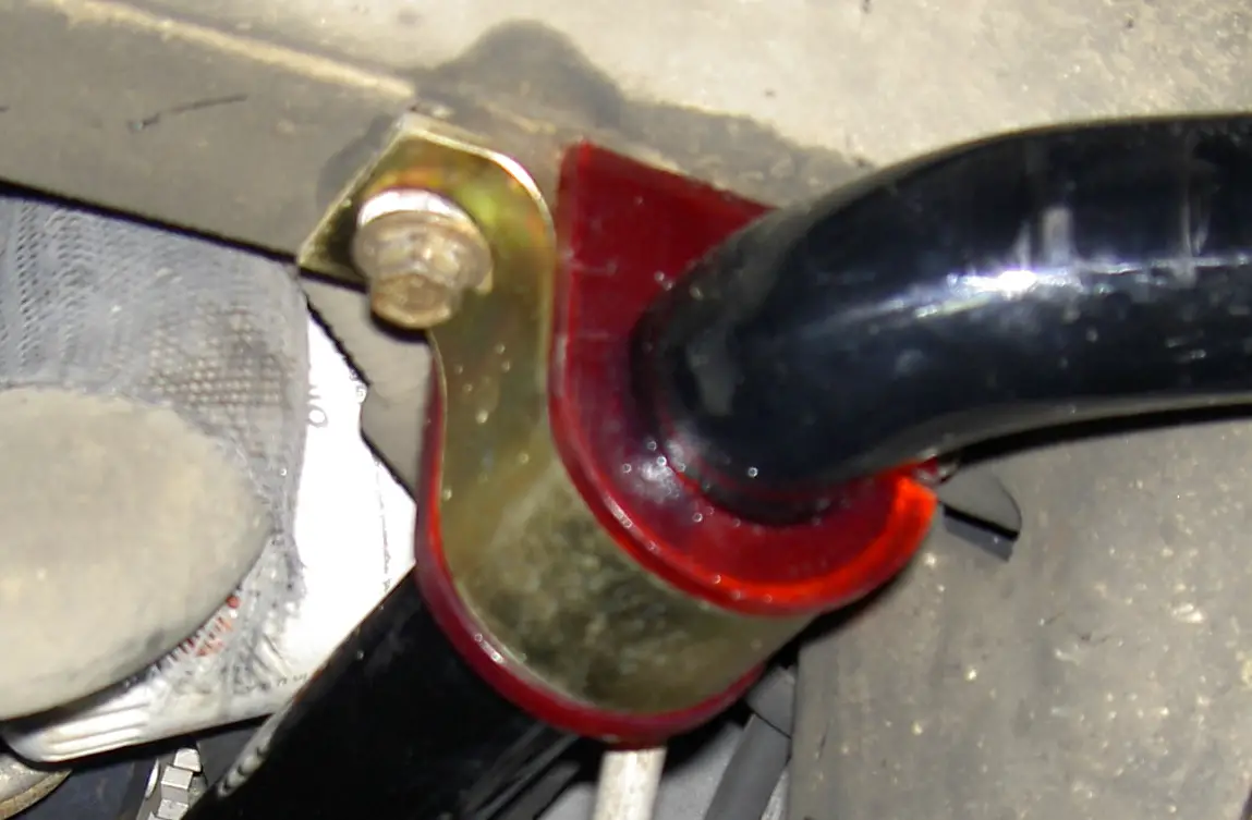

Yeah from my searching it has been hard to find an improved sway bar front or back. The best I've come up with is just installing the poly bushings, which I will do on the rear first since I haven't touched it. I can feel in corners the rear end sways more.

Use either the ES 4.5153 or Prothane 61132 poly kit. Confirm your rear sway bar size (19mm) by measuring with a caliper, adjustable crescent, or open end wrench. Easy install, but the pressed in stock end link metal sleeves must be removed. Many say this is the best bang for the buck handling upgrade.

So the transmission will actually skip a gear with low throttle input that's pretty cool.
It doesn’t actually. The 5r’s “2nd gear” is just first gear, plus a converter lockup. It doesn’t have another gear than the 4r55e, it just has a second converter lockup.
