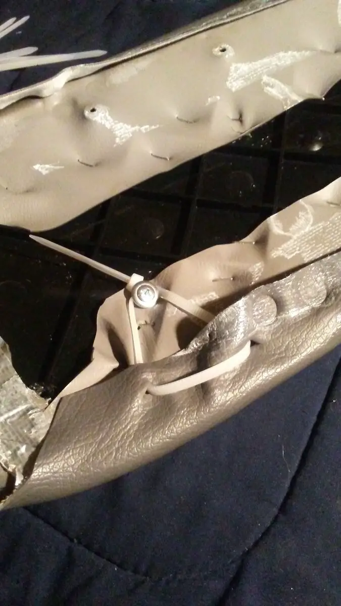

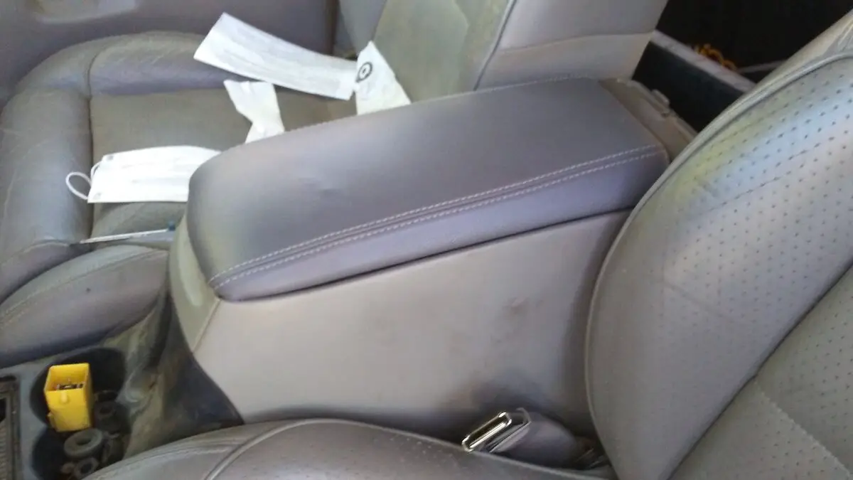

Just so happens I redid mine last night (don't have upholstery staple gun so initial install was poor of new cover material) using a crude but effective macguyver approach; I ran screws w/ zip-ties all across underside with zip-tie pressure as well (as you can see) and nothing broke loose etc...holding like a champ and looks great imo. (A cover plate goes over all this so nobody's the wiser)

Just so happens I redid mine last night (don't have upholstery staple gun so initial install was poor of new cover material) using a crude but effective macguyver approach I ran screws w/ zip-ties all across underside with zip-tie pressure as well (as you can see) and nothing broke loose etc...holding like a champ and looks great imo. (A cover plate goes over all this so nobody's the wiser)
View attachment 425097 View attachment 425098
Looks great!
/\ That's who I got my grey cover from.... yeah, can't beat the price.
I like it a lot, at a glance it can pass for real leather..
It makes that blotch on side of console and off roading dust around cup holder stand out!... have to get to cleaning that up tomorrow.

Unless you happen to have a upholstery staple gun (unlikely right?) .... go with my method. (** I tried an Arrow T25 staple gun to no avail...) Or if you don't mind dropping $40 go with complete ready to go lid (these weren't on Ebay when I got my cover)...see here:
**These covers work best if you ONLY have cracks in existing padding....holes / large pitting of foam will noticeably transfer through, as you can see that spot on mine. I used expanding foam to fill in hole, and then plumbers putty for top surface and smoothed like one would bondo, and although pretty decent considering, still reveals imperfections, as expected, but a thousand times better overall then what it was prior.
