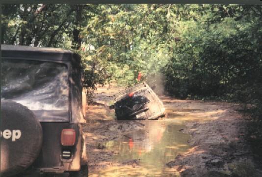

Glad it worked out OK... my friend wasn't that lucky... about a year ago we went wheeling to the Badlands... he took his wife's almost new Cherokee... and see what happened:
he ended-up taking it back to the dealer... told them he got stuck under viaduct during rain storm (pretty common for these to get flooded during rain storms here in Chicago)... truck was never the same. Jeep is not any better than Ford - you could of been looking at thousands of dollars in engine/tranny work... you just got lucky.

to be honest... issue with the Jeep was not so much about the engine... although she swallowed a lot of water... but with electrical system. He had water in his instrument cluster... fuse box and all the important connectors in his dash... it was a ghost truck after the dive... lights would come on and go by themself... radio would start going through stations like crazy... no turn signals... and lots and lots of other problems... to tell you the truth though... this guy drove his Jeep home after we cleaned water out of the engine... never changed any fluids untill it was too late... he drove 250 miles before getting home. It was kind of hard to do it all on the spot but not totally impossible. You're right... if you take care of it right away, it should be fine.
