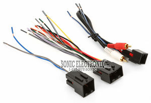

I would like to hook up the factory sub to my kenwood hrad unit. I have a 02 eb with premium sound. I don't know much about wiring so please explain in simple terms thanks.

They sell a harness that hooks up the stock subwoofer harness. You will need an y adapter to bring your two rca outs on the hu to the one one the harness. It also has a wire you hook up amp on. It also needs a ground. My alpine harness has an amp ground so I went with that.
You will also need to install a resistor in the amp on power. I beleive a 2.3k ohm is what I used. The factory amp has a different turn on voltage then what after market amps use. If you don't use a resistor there is a large pop sound ever time you turn on and off your HU.

Look around for the harness online. I can't remember who makes it. For the resistor I just went with one from radio shack.
The other thing you could use over a resistor is a voltage regulator. But thats make a lot of heat and you need to mount it to metal to sink away that heat.
for the resistor, ask the guy behind the counter at Radio Shack
Metra Electronics harness 70-5701

I have that harness metra-70-5701 but I don't know where to attached remaining available wires beside speakers, could you help or any place to go read or watch video? there are no instructions about which wires for steerling wheel contral, or subwoofer etc.
