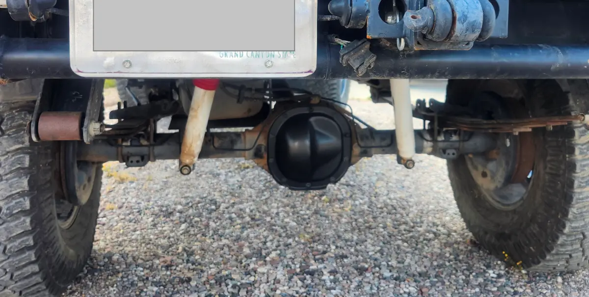

The ABS sensor on the rear is the on the diff housing and reads the big toothed disk next to the ring gear. I didn't change the disk, so it sends the same number of pulses per axle rev as before.

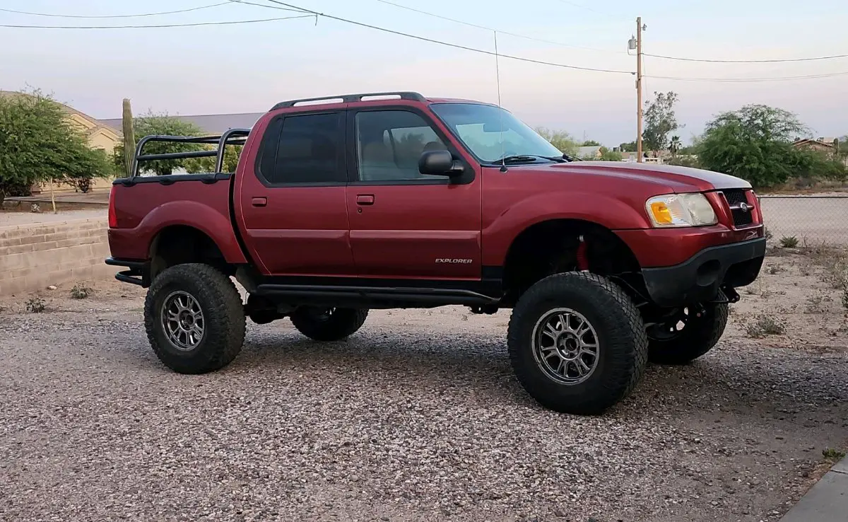

Background -- Well to make a long story short, I've had the ST since new, starting wheeling it maybe 10 yrs ago, got tired of no front suspension travel and CV's binding up/breaking and did a Dana 30 SAS on Wagoneer leafs, and just put the 8.8 SOA. Just copied all the great work done by 410 and also all the other SAS's in the Registry. Here are a couple pics of my pig.

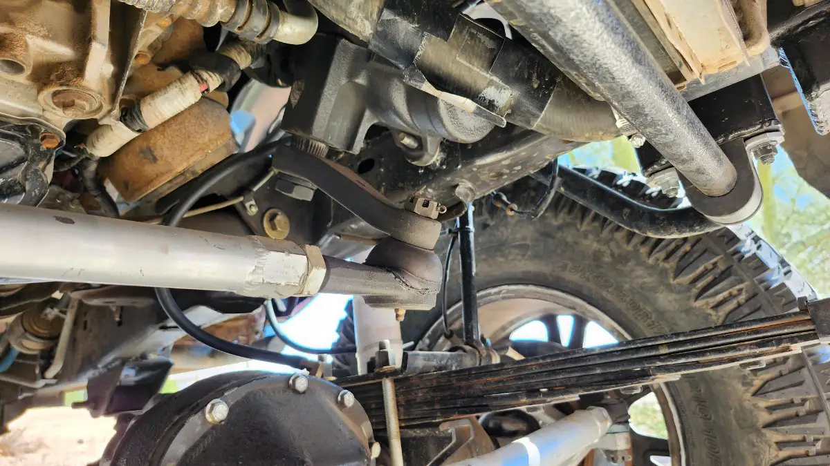

For steering box, I just copied the SAS traiblazers that came before: std Ford gearbox, mounted inside frame with the frame plated. I positioned the box so that I could use the std ranger steering shaft. I'll grab some photos to share.
Man, the track bar didnt go well. I tried to use a 3" lift adapter to raise the axle mounting location, and then welded a mount to the inside of the frame. The track bar was pretty short tho, and deformed the leafs pretty good on suspension cycling. Ended up giving up. My steering is a bit boatish, lol.

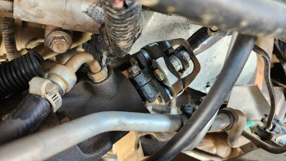

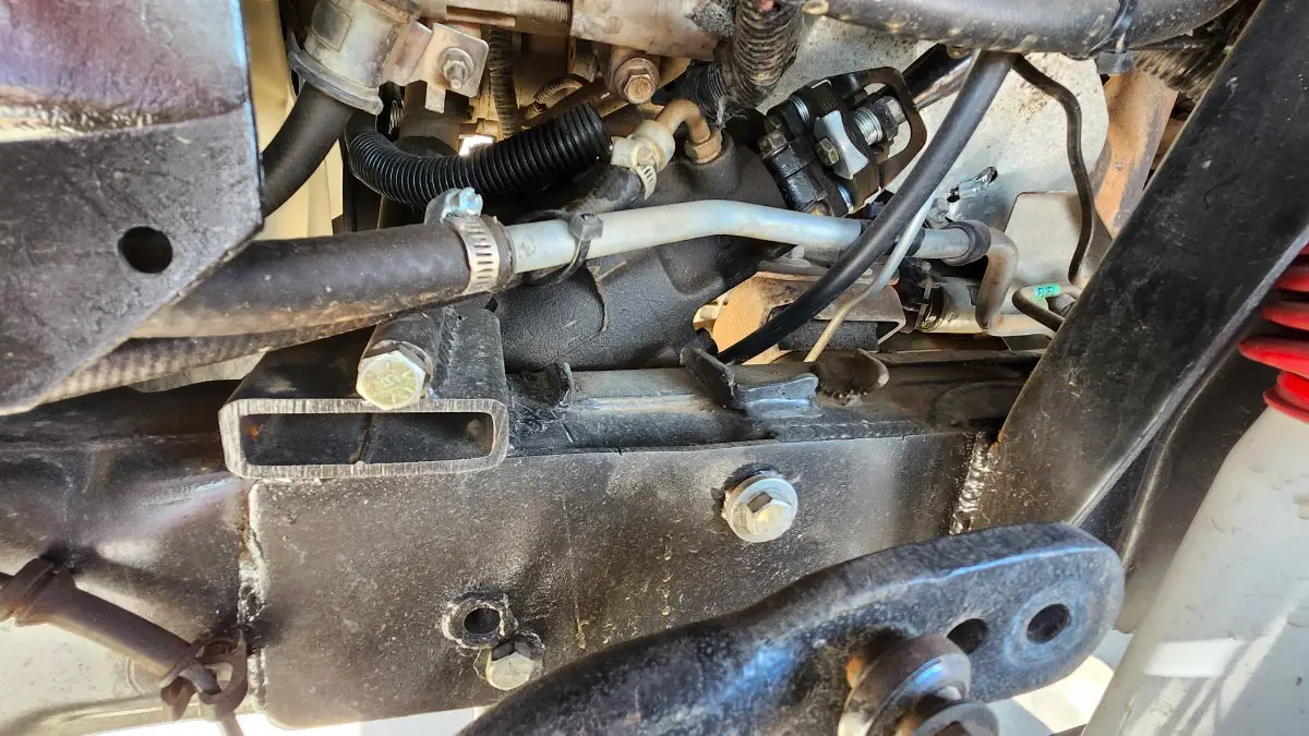

Here are the pics I promised of the steering. Had to replace the torn rag joint, so got a Lares 207 replacement coupler and had to add a bnuch of washers and to get it to pivot correctly. Had to get a custom pressure-side hose made to fit with the A/C compressor so close.

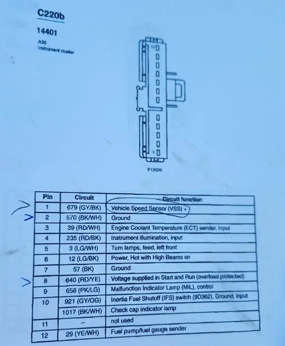

3) Wired in in like 410 said: See pics.
a) Splice into the rear diff speed sensor wire where it runs into the ABS module under the hood. Leave the connection, just add the new wire and run it into the cabin.
b) Add 3 wires from speedo connector in instrument panel. Note Ign and gnd need to stay intact, just splice in your added wire. The speedo vss signal wire is cut and only the new wire is tied to the speedo. Just put a cap on the unused OEM vss source wire.
