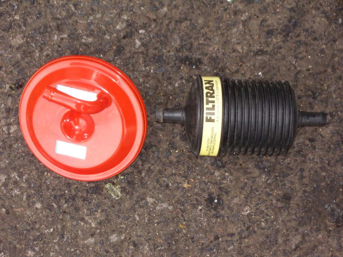

I'm currently using the orange metal filter on the left side of the photo.
I'll have to check the hose out. I'm not sure if it's ever been done, I'm at 165k so I'm sure it's definitely dirty. No panic stops yet, I've been actually babying her at the moment. But it feels so much better without the shakes, nice and smooth. I'm sure was warped rotor and both calipers had frozen pins.
I've didn't even see that orange type filter, how does that work? Inside the reservoir?
It goes in the return line.
I can't picture it in my head, justs seems to big to go in the return line

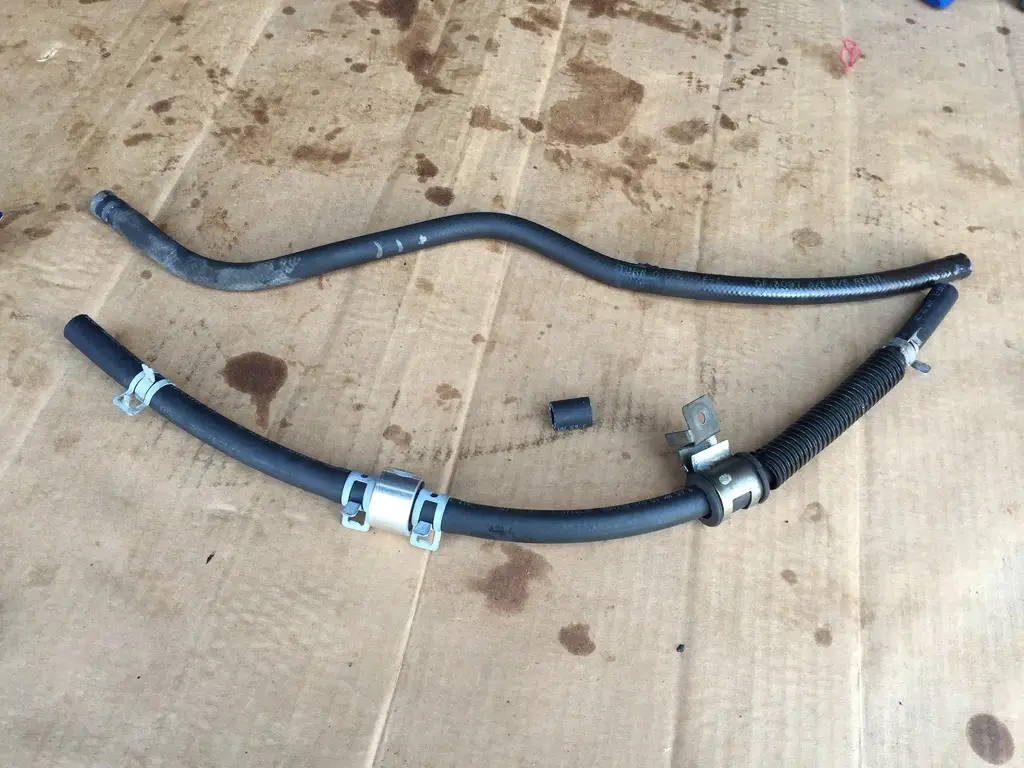

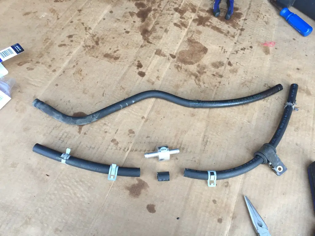

So I decided to flush the power steering and add the inline filter today. Since I would need to remove the return line to even put the filter on, I decided to replace the hose too.
return hose acdelco p/n 36-361960
inline filter magna-pure p/n 20-0038f
Mob1 full synthetic Mercon v
I decided to jack the truck up to get my new tires off the ground- for the turning lock to lock.
I used a turkey Baster to suction out as much fluid as I could. It was dark brown/blackish.
I took off the nut for the hose bracket (below reservoir), you can access via wheel well with a 10 mm.
Pulled clamp down from the reservoir nipple and slipped hose off and added a 3/8 vacuum cap.
I didn't add an extension hose to the return line to drain nice into a canister AND made a mess of things. I fished the hose down and put a pan under.
I filled reservoir up and turned lock to lock (engine off). I used only 1 qt until it ran red. I think I got some air in.
I pulled hose off the cooler and put a 3/8 vacuum cap on the nipple.
I sharpie a good location on the old hose before I removed it. Then lined up old and new to mark cuts. Cut hose just enough to keep the same length with the filter.
Then re attached everything. Filled reservoir and turned lock to lock (engine off). Checked and filled reservoir, did this a few times before turning engine on. Gave it a second then turned lock to lock- which it started to shutter and more turning made it violent. So I turned off and started to check things, this is where I think I had air in the system. I kept turning the wheel with engine off and it seemed smooth, the fluid was getting less foamy. I lowered the truck to the ground and went around the parking lot. Everything seemed fine. Went for a 10 min drive and it still seems all good- haven't noticed any leaks.
