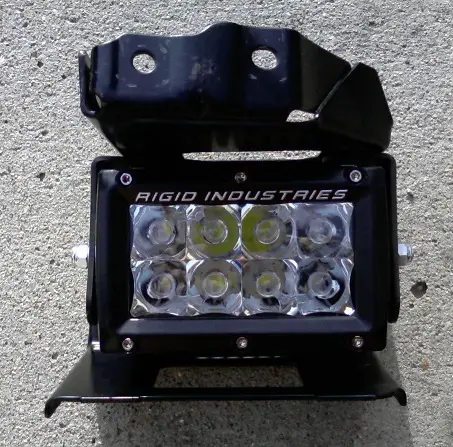

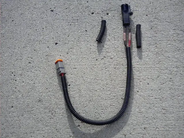

I have the rectangular fog lights on my 96. I swapped one side for a small Rigid Industries LED bar. Wiring was discussed with @Turdle, and he suggested just wiring it to the OEM harness.
Nice! I might just have to do that, I was more interested in the bulb thinking it'd be cheaper and I had to do it anyways; but it looks pretty comparable in terms of difficulty. I'll have to look and see which ones I can just use with the stock wiring. I don't need it to be blinding, just wanted to see if I could go brighter than what I have now/high beams kinda blow.
They mounted pretty easily/similarly to the stock fog lights?

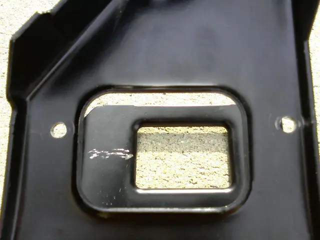

Drilled two holes on top of OEM bracket, and carved out on the back for the Rigid plug.
Trimming the valence was pry the hardest part…
