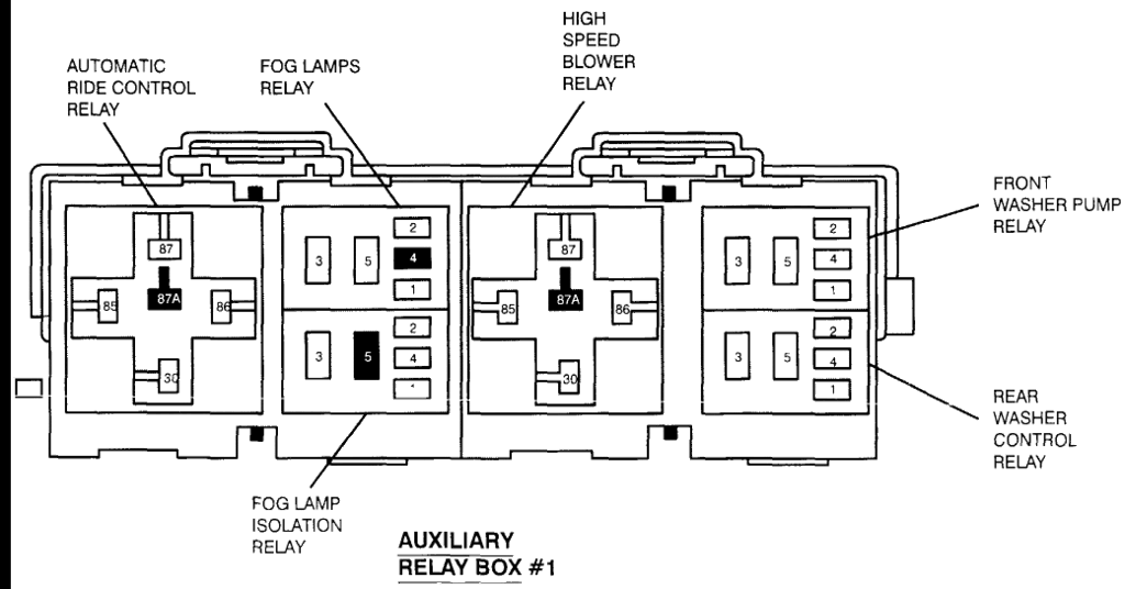

There is also a relay in the relay box under the air filter box. that relay could be bad.
Here's the location:
Thanks for the info. I have changed the relay in the aux. box 1 already. I have power to the switch inside, when the switch is depressed it does not turn on the lights and the indicator on the switch does not light up either. I had read in one of the threads about a module that can go. Does anyone know of this module and where it is located.
If you power at the switch then follow this diagram and see where you're losing power. The switch has power to it all the time and it goes to ground to activate the relay. The relay closes and sends power to the fog lights and the switch light. There is also the isolation relay too. The fog lamp relay gets its power from that.
