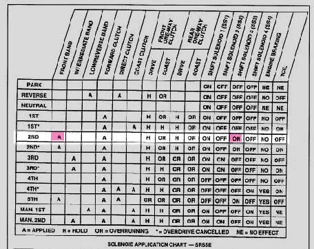

As far as the 733 code. The way I understand it (please, others correct me if I'm off base) the PCM has known good shift parameters (based on all the sensor inputs) when a shift point is outside of tolerance it trys to apply a code (reason) for the problem. Shift solenoids are a two wire arrangement (only power applied) and there are no sensors to detect if the SS opened or closed fully. I think it is easier to say that the solenoid failed instead of valve "X" in Bore "Y" failed to close off port "n" resulting in a delay shift. Basically there can be many reasons other then the SS being bad.
One thing you may try if the SS test OK is to switch SS3 with another SS and see if your symptom changes since they are all the same.
In looking at the following chart and your symptom (delayed 2nd gear) SS3 is engaged for the first time for the 2nd gear shift.

That's what I was going to try if all the SS tested good. I plan on testing the SS's a few times just to make sure.
