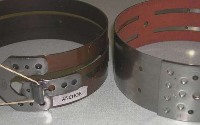

I was going to tighten the bands and after inspecting the intermediate band through the small opening with the VB removed I found what appeared to be a hairline crack. I couldn't get my finger to it but with a small screwdriver I could feel something that felt like a crack. Not sure. I took a picture for future reference. I was feeling a bit down because I thought I had done everything for nothing and that the symptoms would still be there. Needless to say I am treating the transmission like a cracked egg now and not stressing it. I would recommend inspecting this before playing with the band adjustment.
