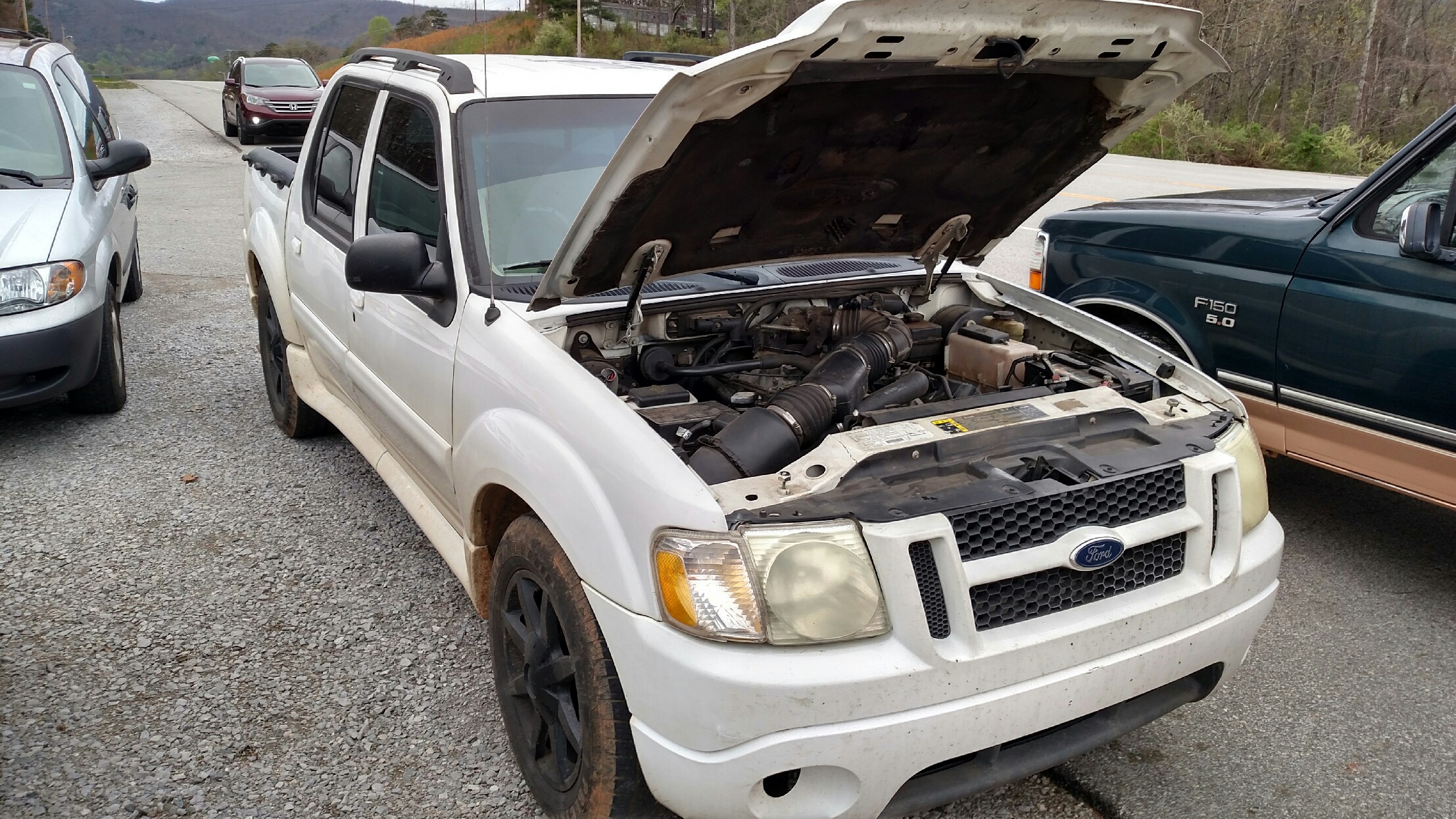

I went to pick my son's Sport Trac from having the engine replaced with a used one. There was a white ST in the parking lot and I asked about it. They said the mechanic that put the engine in my son's truck owned it. He said he put an engine in his awhile back. Except he put a V-10 in it from a E-350. He used the transmission from the E-350, his truck is 2 wheel drive. He is using a V8 Explorer radiator, had to relocate the brake booster, fuse box, overflow and reroute the steering shaft to clear the exhaust. The engine is way back with good room between the fan and the radiator. It looks pretty stock. He said it is real fast, not sure I totally believe spme of the speed and mpg numbers he gave so I won't post them. Below are the pictures.

Interesting what he did to the AC box.

Wow. He must have used a shoehorn to stuff a V10 in there. Just goes to prove that you can pretty much stuff any engine into anything if you have enough fabrication skills. Ever see a mid 60's Corvair with a 350 V8?
Considering the v10 is an all aluminum and a sport trac is half the weight of an excursion I bet it has great power and gets great fuel economy. Probably not over 20 mpg ever but still super sweet.

As I said he had to have been streching the truth about his numbers. Thats why I didn't even want to mention them at first. He did a good job putting my Son's engine in. What's weird is most of what he said seemed acurate and was visible to my somewhat trained eye. He said he has the 3.55 gears with the V-10's five speed automatic transmission. This took alot of work and is real tite against the firewall. Maybe his speedo is way off which would make him think he is going faster and further than he really is.
