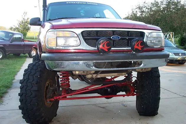

So far i have the the rear sprung over and i am in the process of dissasembling the front.The gears are being installed and my axles are being rebuilt as i speak. I will post more pics as soon as i get them and keep you all updated. Here is one that i could get of the d44. More pics will be up later tonight hopefully.Feel free to ask questions as i will.

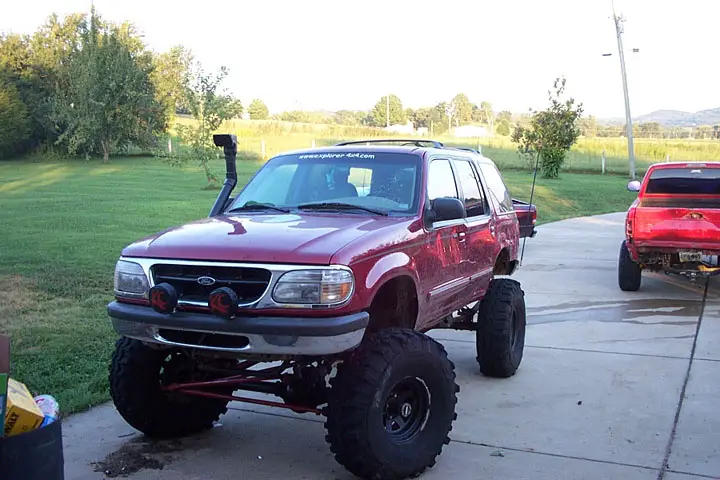

What u all have been waiting for
Pics!

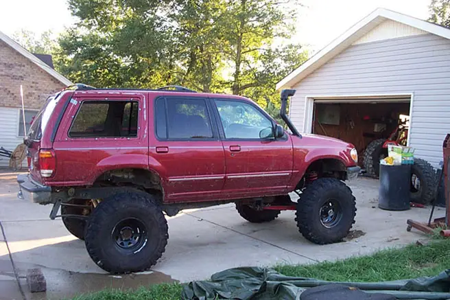

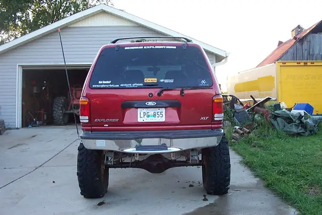

I actually wheeled it last weekend for the first time. It did great, i was very impressed with its performance and so were my friends. I had a problem with the PowerSteering again and had a problem with one of my rear calipers. I got the PS some what fixed but im still having a problem with the steering. I can turn all the way to the right but i cant get a full lock to the right. I think im going to mess with the pitman arm a bit to get it right.
I drives alright on the road but it wants to sway a bit. Me and my friend made a custom drop pitman arm and put a steering stabilizer on there and that helped it out a bit. It also needs an alignment. I just have to fix that brake problem and get a tracbar made for the rear and she is pretty much set.I figure i have about 11 inces of lift on it total. I didnt have to trim at all for the 38's.THe rims i put on them are 15X8 and they work great. I was running 5psi in them and never had a problem.

jamest- Its already been done :D . You cant beat the traction of it but its like wrestling with a monkey to steer. I unlock a hub and it helps a little, Im probably going to save up and get a powertrax or a detroit. I love that mini spool in the rear, but the tires dont :smoke:
Heres a side pic. THat 3rd window is the one i broke. Its ready for the canvas window to go in.Sheesh she's dirty.Hasnt been washed in two months.

your passenger rear springs looks like they have some bad negative arch. is that just the pic or are you getting that much spring wrap?
