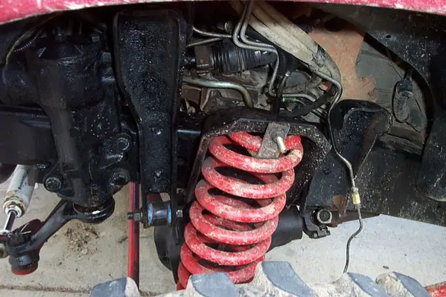

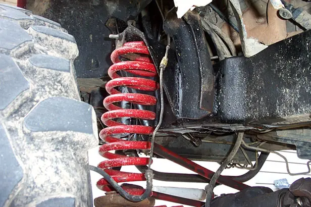

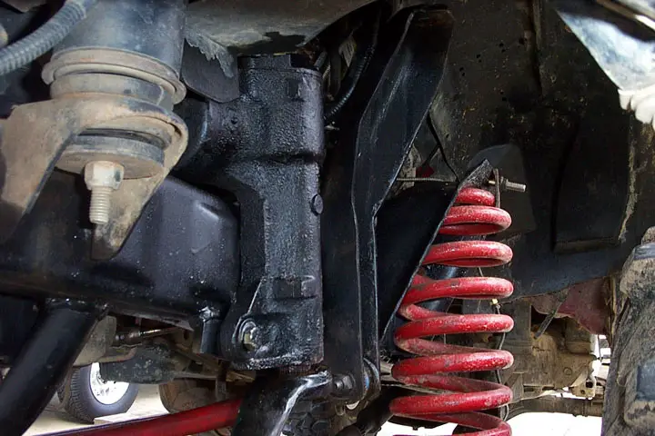

Here are some pics of my buckets

What power steering box is that exactly? I scanned the thread and didn't see a mention of it...maybe I missed it.
I'm guessing you've got the 4 Liter engine? I'm trying to figure out what steering box is going to give me the least grief since the V8 eats up all the space under there.
I could do an oil filter relocation, but I like the way that box sits outside the rail, I'm just wondering if it'll fit with my AC pump that's right inside and above the rail.
Do you have any pics of it from underneath? Or just more pics?
Thanks!
Its a saginaw box from a 79 bronco. It should work for u on the outside of the frame rail. I believe my ac pump is right where yours is too. The only really challenging thing is to get the stock steering shaft to work. I beleive we shortened mine and welded the old r&p connection to the bronco box so the shaft would work. I have only one problem from that setup though, the rubber boot on the shaft rubs on my brakelines in there. Ill get some more pics today,
Matt
Sweet! I was looking at the Saginaw from the 99 Grand Cherokee, it sits on top of the frame rail, but I like the way yours fits in there...did you sleeve the frame?
FYI the old 4x4 F150 box is the same as the 78-79 Bronco.
sweet!
I like those skinny 38s. Those are sweet.
Did you use uncut coil buckets from that 79 bronco?
I'd do something about those brake lines if i was you.. they're not safe other wise looks pretty good.
