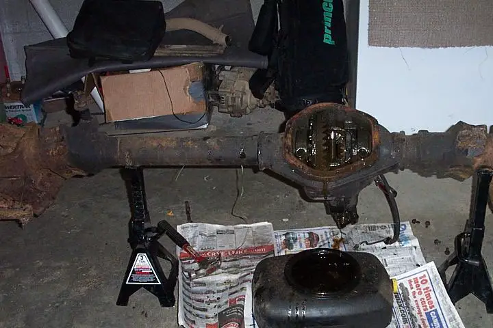

So far i have the the rear sprung over and i am in the process of dissasembling the front.The gears are being installed and my axles are being rebuilt as i speak. I will post more pics as soon as i get them and keep you all updated. Here is one that i could get of the d44. More pics will be up later tonight hopefully.Feel free to ask questions as i will.

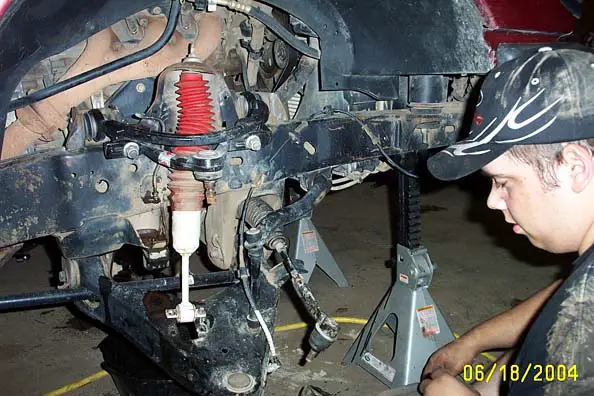

Front end on jack stands
