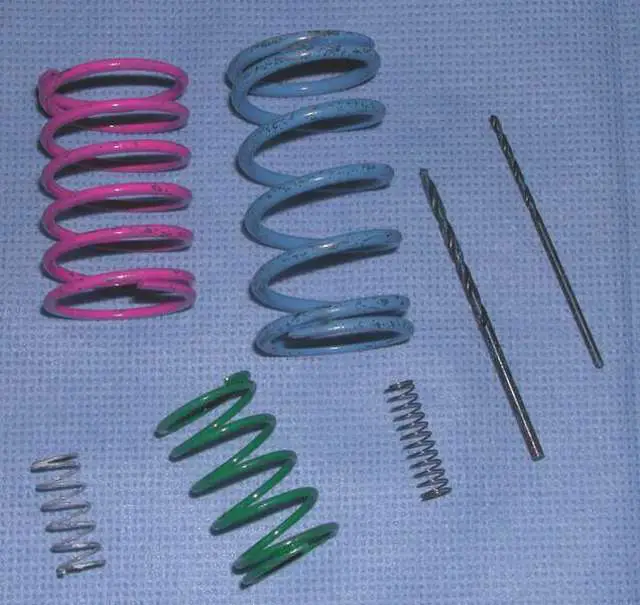

Look like any of these?
it sounds like it is from the valvebody somewhere do you have a digital camera to post a picture of it. It is possible it came from the old valvebody but i doubt it. Do you have any shifting problems?
now those look like a mod kit?
Honestly, to lose a spring the VB would need to have a major failure because they are held in the bores by retainer clips which hold the plugs. If that spring was from your existing VB there would be other parts in the pan as well. It's possible that doruing the repair the spring found it's way into the pan and went unnoticed.
Yes, that is a pic of springs from a VB kit.
Matt
It looks most like the spring on the lower right.My spring is 3/16 in diameter and 1/4 tall with only three and a half coils.It has a little bit of dark blue paint on it.
The Explorer seems to shift alright.Very smooth transitions between shifts.Sometimes I think there might be a slight flare up but it might be in my head from reading about problems on this site.My 93 Ranger had much firmer shifts.Does this sound right?
