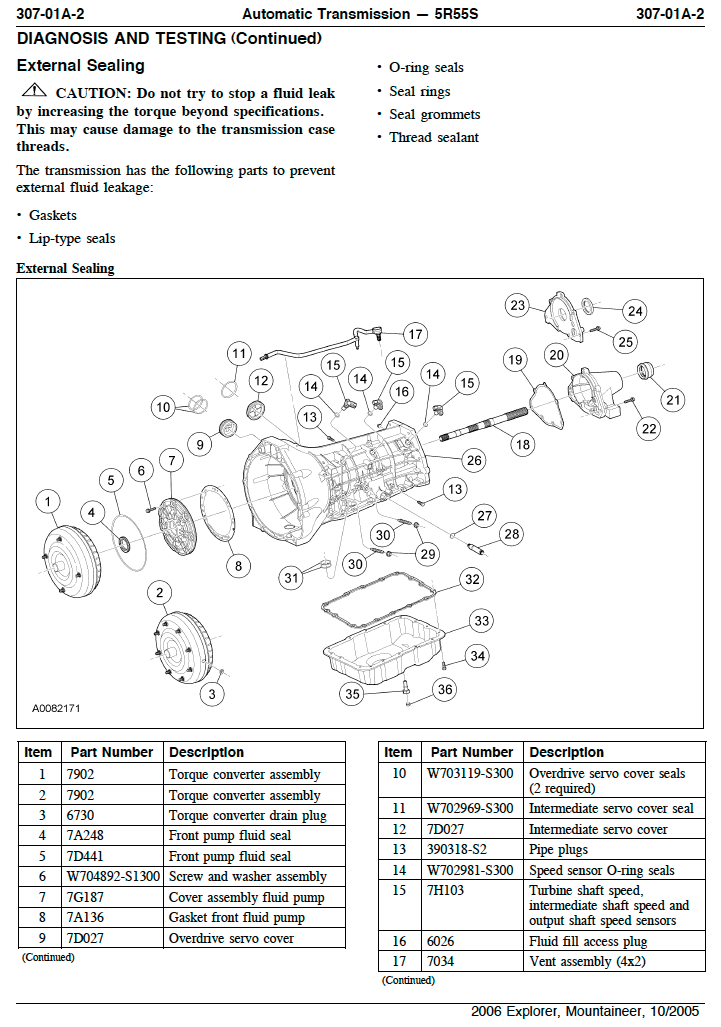

Traced the connected end to the top of the Tranny there is a slight drip of Transmission fluid coming from the hose. I have looked all over at the length of the hose to see where it might go but, can't find it. Does anyone know what is called so I can try to look up a diagram?
Thanks!
Probably the tranny breather tube. Just run it up somewhere in the frame. It allows air to enter/exit the trans.
Yep, it connects to the Case Vent, 7034, near the back top of the tranny:
