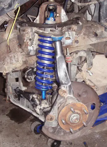

Here are a few pic's of my fox shock that i just installed. :D
and one more

really fox has been making off road racing shock for truck and suv for a while know most baja trucks and buggies have the fox shock. I just got some custom bracket and mounted those babies right on there. It was a little pain because i got the shock like a inch longer then my full down stoke on my explorer. So me and my uncle had to get a jack and jack the shaft on the shock up some to get it to fit in the braket the shock are nitrogeon filled i have mine at 200 psi. Your know what fun once i put the shocks on it made my X sit a little higer :D.

are you going to put gussets along the frame up to the shock pocket ?
because if they are holding weight they will flex that shock pocket and might crack the welds on it to the frame ,,
they have been making truck shocks for a while,,
like these,,
