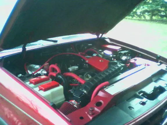

If you have no welder I say its not worth trying , your going to have to make some kind of braces and brackets because the parts are not that Similar
Added Pic For Reference
SO I should leave the existing rad support in place and find some other means (like making brackets) to mount the parts to.
In theory the first gen clip should be bigger right? I' hoping maybe it can fit around the second gen rad support and be held on with some sort of extensions.
