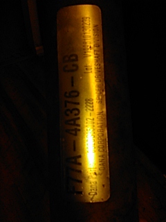

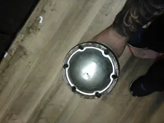

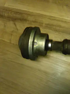

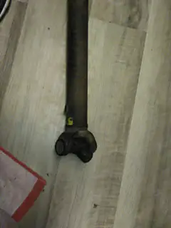

I'll have to send pictures and just repost this . my problem is my rear driveshaft is pulled out it has a round CV joint on the end rear and a u joint front . only my front tires spin its my rear I only find the kit for the front drive shaft wtf . its a round joint this is my rear driveshaft

That is the front driveshaft, same for all 98-01 Explorers. The V6 version is a little longer, but the CV joint there is identical.

Well IMA say its the same pukin part as the front just pulled my front out a bit its the same looking CV as the rear drive I'm holding so this site costed me a u joint awesome .
...my problem is my rear driveshaft is pulled out it has a round CV joint on the end rear and a u joint front . only my front tires spin its my rear I only find the kit for the front drive shaft wtf . its a round joint this is my rear driveshaft
Are you sure it's the rear shaft you have removed, the picture is of a front shaft? I have pictures of my front shafts along my rebuilding of the friont suspension long ago, it's the same as that.
That front shaft is very small, you can wrap any fingers around it. The rear shaft is much larger, about 3" in diameter, and longer, maybe five feet long. The rear shaft will have a flat flange at the rear that bolts to the diff.
