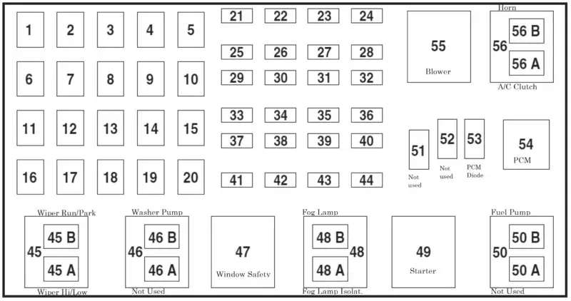

Have you tried the highest speeds? I had a relay issue where that the only speeds I had were the fastest two, everything else was dead as a nail. Your owners guide should have a relay diagram for underneath the hood, or a simple Google search will turn one up, I found mine by switching the two wiper speed relays around.

I replaced both wiper relays, 45 A/45 B, on my 2001 Job 1 Sport Trac due to no Hi Speed wiper movement. Completely fixed the problem, wipers run stronger now at all selected speeds.
