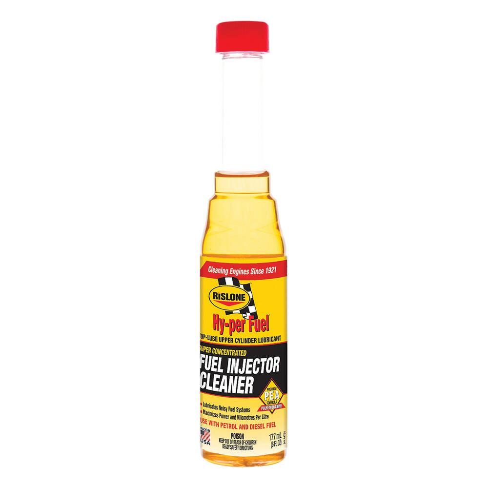

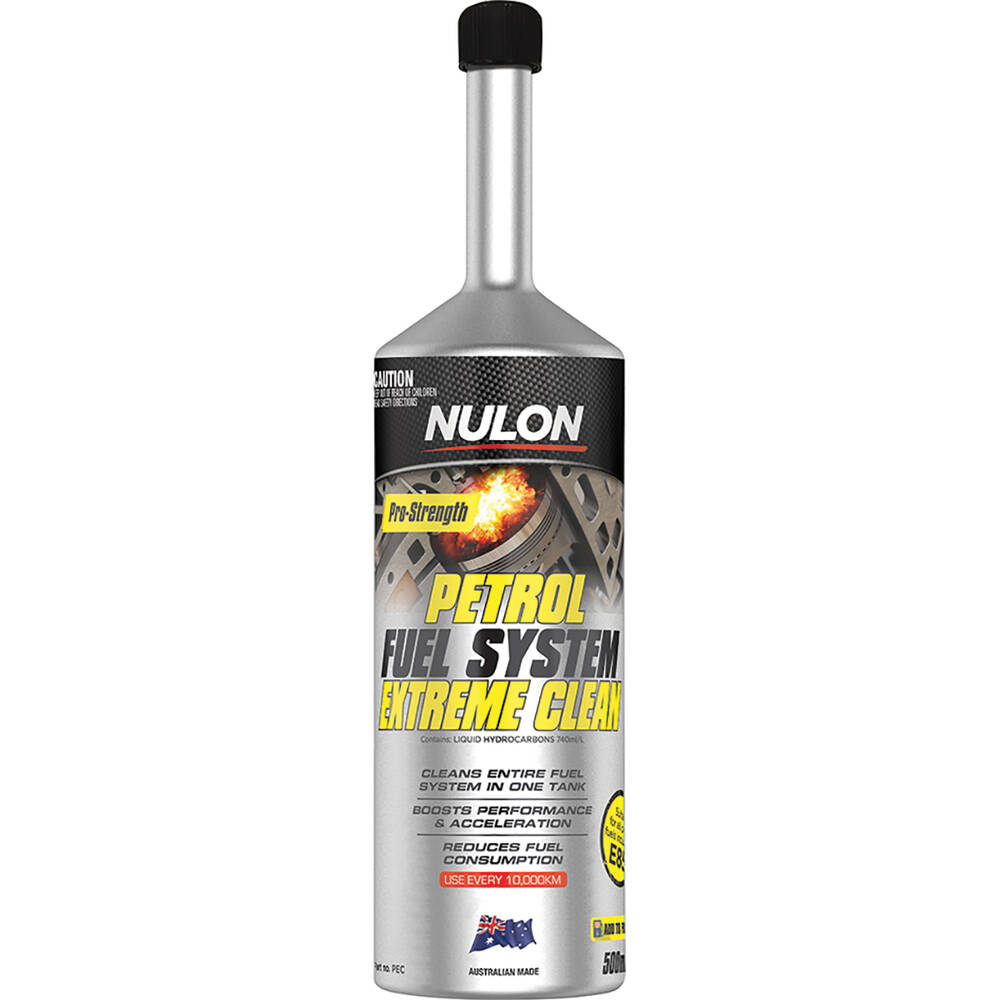

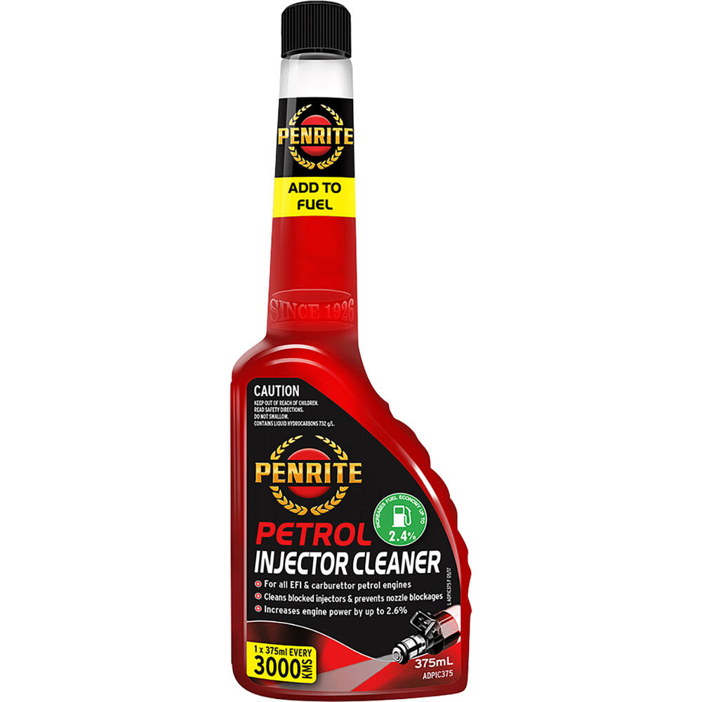

I have a 2002 Ford Explorer 4.6L V8 Limited Edition (UT Model) that is idling roughly. Before I address the plugs and coils, as a first step I will try a fuel cleaner - maybe the injectors? Can you make make your recommendations for what brand/cleaner you have used with success please.
Here are a few I'm considering
Rislone High-Performance Injector Cleaner - 177mL
Nulon Pro Strength Petrol System Extreme Clean - 500ml
Penrite Petrol Injector Cleaner - 375ml

Can you get sea foam down there? It's a decent fuel system cleaner and will help clean the gunk and water out of the tank. Dump a can into the tank right before filling up then run through the tank. The do it again except with the techron injector cleaner. Techron has PEA which is what you want to clean carbon from the injectors. After that tank is mostly empty, replace your fuel filter. The old filter on mine drained something resembling very old used motor oil but after almost 20 years it was understandable.
Liquid moly brand makes some good stuff, not sure about the stuff you linked. You really want PEA cleaner for injectors.
