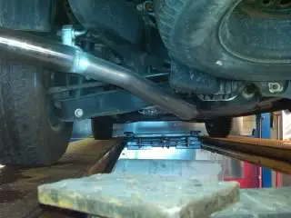

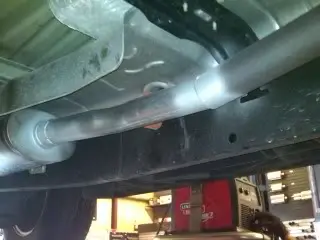

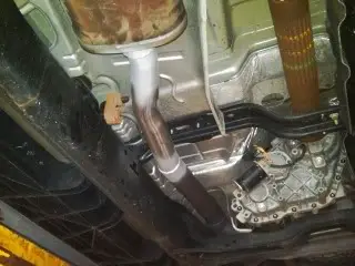

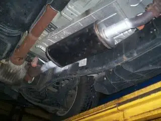

Just so you know, i ran my exhaust under the rear axle. for my 05 there is no resonator before the factory muffler, but a major clamp in the exhaust. I deleted the clamp in the exhaust, and ran 2.5'' off the Y-PIPE to the MUFFLER, and 2.5'' under the axle, then exit @ a 45 degree angle...
here is pics of my exhaust through the stages... STOCK to CURRENT...
***** alot of pics so be warned... *****
1. STOCK
2. MUFFLER + TIP
3. 2.5'' EXHAUST
