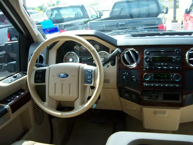

I just noticed that the new super duties use the same gear shifter as in our explorers!
hahahaha
Apparently Ford liked the gear shifter design in our explorer so much they transfered it over to their new flagship truck?
haha
I'm sure they worked out all the kinks with it though.
