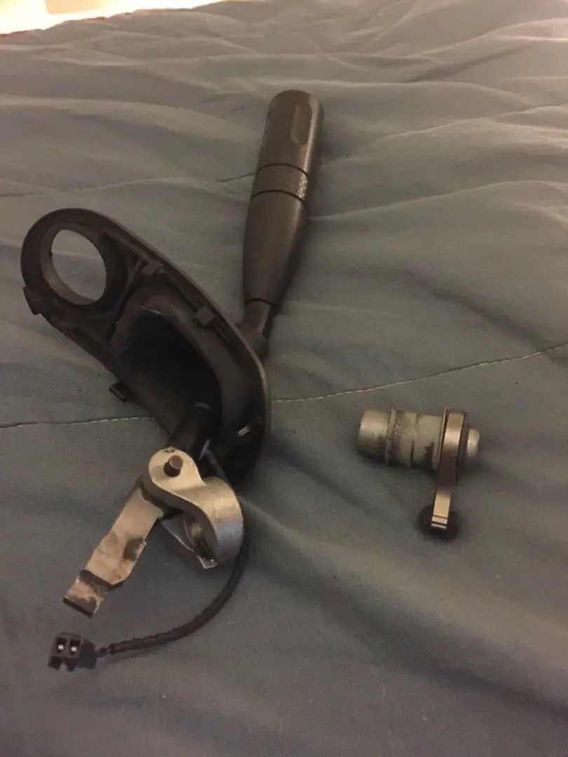

Thank you to everyone for posting in this forum. I had my column shifter break last week and after reading the forums I was able to fix this in roughly two hours.
I saw a lot of questions asking what exactly is the clip that needs to be pried or dremeled out. I found it pretty easy to remove the clip. I stuck a small screw driver in between the old column shifter and the clip, then I banged it with a hammer for a bit going around the clip until it opened a big enough space to pry it out with a bigger flathead.
Here is a pic of the clip almost out:
Here is a pic of the clip once it is out.
One thing that I found out the hard way is that under the column shifter there is what I think is an electric solenoid. After putting the part in I was having trouble putting the shifter through all gears with out any binding. In fact I was getting stuck due to a small gray bar that was blocking it. As it turns out because I had the battery disconnected the solenoid was not releasing. After I connected the battery the shifter works perfect.
Hope this helps someone.

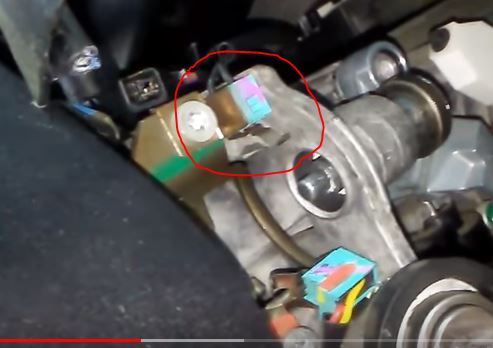

Does anyone know what the circled clip does? My son's gear shifter broke off and was replaced. This metal clip/connector is missing. I know the bottom one allows the key to be removed when depressed. thanks
Well. Here goes. Thought somebody might be able to use this info about my experience with my wife's 2002 E.B. Explorer.
I got the call from her this morning that she just arrived at work and the gear shifter broke off in her hands. Could not get the key out so I had to haul over and trade out trucks.
Once I got it home I found that a major aluminum part had sheared off! Now, I am no expert when it comes to metal, but I do tinker with aluminum and soft metals in my garage making stuff for RC Airplanes. So, I know a little about this kind of stuff and I know that what I am looking at should have never broken, unless the batch of aluminum they used to cast the part was tainted with something or maybe an air bubble got in the cast.
But, here are the pictures that I have taken.
http://img.photobucket.com/albums/v679/newtek007/2002 ExplorerShifter/IMG_9354.jpg
http://img.photobucket.com/albums/v679/newtek007/2002 ExplorerShifter/IMG_9355.jpg
http://img.photobucket.com/albums/v679/newtek007/2002 ExplorerShifter/IMG_9360.jpg
http://img.photobucket.com/albums/v679/newtek007/2002 ExplorerShifter/IMG_9358.jpg
http://img.photobucket.com/albums/v679/newtek007/2002 ExplorerShifter/IMG_9356.jpg
http://img.photobucket.com/albums/v679/newtek007/2002 ExplorerShifter/IMG_9366.jpg
http://img.photobucket.com/albums/v679/newtek007/2002 ExplorerShifter/IMG_9367.jpg
http://img.photobucket.com/albums/v679/newtek007/2002 ExplorerShifter/IMG_9368.jpg
http://img.photobucket.com/albums/v679/newtek007/2002 ExplorerShifter/IMG_9369.jpg
http://img.photobucket.com/albums/v679/newtek007/2002 ExplorerShifter/IMG_9370.jpg
http://img.photobucket.com/albums/v679/newtek007/2002 ExplorerShifter/IMG_9371.jpg
http://img.photobucket.com/albums/v679/newtek007/2002 ExplorerShifter/IMG_9371-1.jpg
http://img.photobucket.com/albums/v679/newtek007/2002 ExplorerShifter/IMG_9373.jpg
http://img.photobucket.com/albums/v679/newtek007/2002 ExplorerShifter/IMG_9374.jpg
I have not taken pictures since I have Reattached the pieces using PB Weld. I have had great results using this stuff in the past. It is curing in the garage as I write. Hopefully, the jury rig piece will hold up to the stress of shifting the column.
