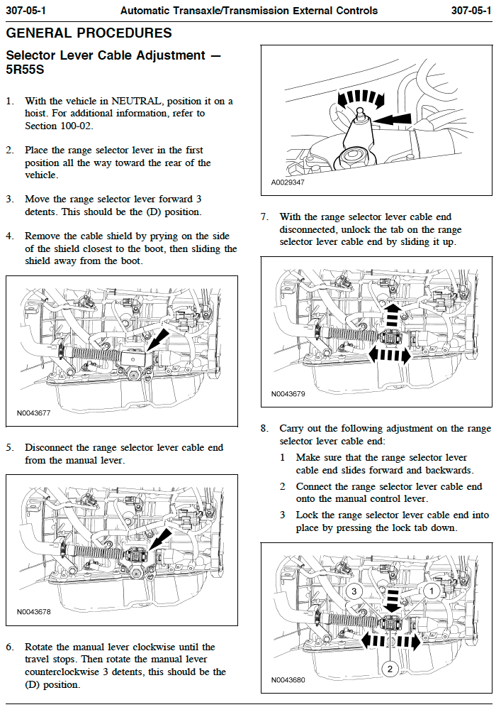

Could the shifter cable be binding? Does it move smoothly once it's free?

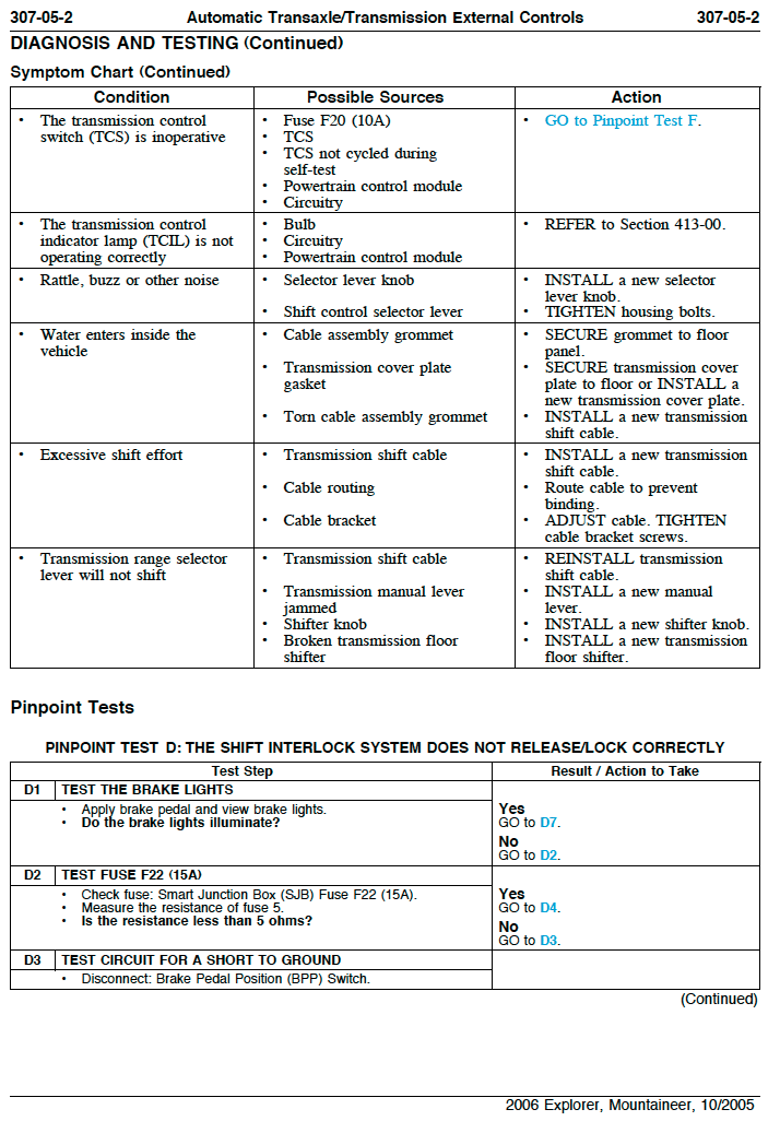

There is a procedure to adjust the transmission shifter cable. That will allow the cable to be detached so you can check for binding and once fixed you can re-attach correctly. The V6 trans is a little more involved (2 procedures) than the V8 because of the external trans range sensor may need adjustment too (the V8 trans has an internal trans range sensor) so only one procedure for the cable.
Ornery may be able to post them, but if not, PM me with your e-mail address.
Good luck.

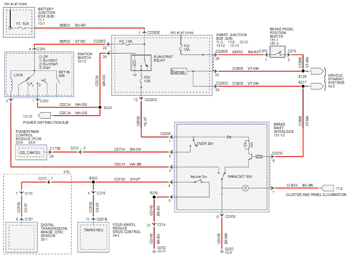

Could be intermittent connection somewhere. I'd first look at connectors in the circuit. Look for corrosion. Spray those connectors with something like "DeoxIT". If that doesn't work, it may be a frayed wire inside the insulation. A tough repair if it's intermittent. I'll drop the wiring diagram in your lap and wish you good luck:
After examining the diagram more closely, I see the brake switch doesn't connect directly to the interlock solenoid. It goes through the "Smart Junction Box". If the relay inside that black box is intermittent, you might as well override the interlock solenoid and forget about it.

Looking at the diagram provided by ornery, Note that the solenoid (upper right quadrant of brake shift interlock circuit) requires three things to operate. It requires 12v from the run start relay in via pin "1". And it requires GRD from the park detect switch in via pin 6. And pin 8 requires a voltage (logic level from smart junction box) through the resistor and to the transistor's base in order to conduct the GRD from the park detect switch. If all three are present the solenoid will operate, unless the solenoid is defective.
The solenoid can be checked with an OHM meter for proper resistance through its windings. Since, you may still have the one you replaced, check them both and compare resistance. And if you provide GRD and 12V it should operate consistently.
Applying GRD to the input (pin 6) of the park detect switch should verify it is conducting. Or check the park detect switch with an ohm meter for continuity.
If you provide GRD directly to the GRD side of the solenoid and it operates, then provide GRD to the output of the park detect switch (input to the transistor's collector) and it does not operate, then the problem is with the signal coming in on pin 8 from the smart junction box.
Replace any defective parts and check wires and connections as appropriate.
