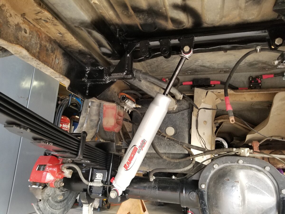

You can replace that cross member by welding a piece of tube across the span with a couple shock mount tabs. That would be your cheapest option. I don't think you could source a replacement. Mine cracked many years ago, and I replaced it with this (this is the third or fourth version).
First version was a piece of square tube welded inside the frame with holes drilled through it for shock bolts. Lasted at least a decade before it bent. This latest one has gussets to keep the frame from flexing and cracking the tube, which it does when off roaded a bunch.

You can see in the picture the remains of the 2x2 tubing that I used as the start of the new cross member. The tubing is 1/4" wall DOM, but you will probably not need that if you are using the Explorer for primarily highway use.
If you are not a avid off roader and just need a cross member you can slap a piece of scrap 2x2 square tubing in between the frame rails and weld it in place, drill a few holes for shock mounts. You should sleeve the holes, but a single sheer mount is fine for a highway car. You should be able to remove the upper mount adaptors and run a 1/2" bolt sleeve through the shock eyelet. Offset the cross member enough so the shocks line up on one side or the other if you are not going to weld mounts onto it. I also saw a cross member that was notched so that the shocks bolted into the inside of 2x2 square tube, but I thought it would weaken the cross member too much.
