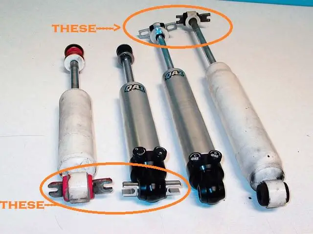

thank you i was just looking at some online.... was also looking on 4 wheel parts as well, just really want something a little stiffer in the rear to help match the front the way the torsion bar are racked up. i read on Ranger Forum that Rancho will do so but may be stiffer then i want. anyone know if i can get the rod with the mounting holes separate from the shock?
I don't know about those, probably something you'll have to make or special order maybe?? I run Rancho 5000's on my rig, it sits on 33's and they are a lil rough but I think it's just right minus the bumps I Feel on the road.
If you are looking to firm up the ride you can also had an add a leaf kit. I'm putting the AAL and rancho shocks on in a week or 2, so if this thread is still around ill update...
only reason i ask about the mounting rods is i have some ranger fx4 level 2 rear shock but need to get the rod in it to mount it unless i buy some shock mounts from racecar engineering... or make my own shock mounts. as far as bumps im not too worried about bumps in the road i will be going to 33's next year.... are you running a 3 inch BL with TT? and shackle?
