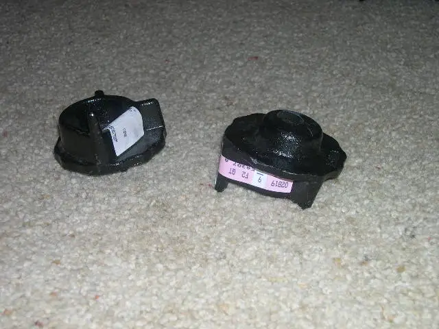

I finally borke down and ordered some coil spacers. At 12 bucks a piece they about broke me;) For those of you unaware, I am currently running a James Duff 2.5" with Michelin LTX AT 31's. I love the lift. The quality and stregnth are amazing, and it turned my Explorer into a well-performing off road vehicle. But I want to add a little height, and adventually get glass fenders and run 33's. But for now I decided to get the spacers.

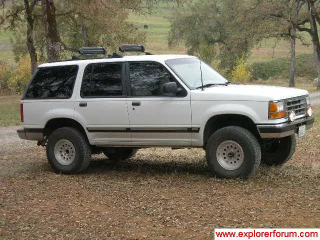

I'm going to agree with everyone else and say go with SOA without the overload and wtih stock length shackles. Thats exactly what I have matched to my 4" lift in front (which is what you will have). See my photo gallery for pics with 33x10.5s.
Byrd - Yours looks huge compared to mine. Very nice job with you setup. I have been looking at your pics for a while now. Are my 31's going to look like Geo Metro tires with that much lift? I would love to get 33's but my tires have about 95% of their life left.
Mine
I think the grass is always greener because yours looks pretty big to me the way it is now. Hehehe. And don't get me started on what 12.5s look like next to my 10.5s.

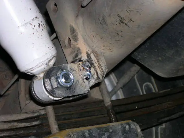

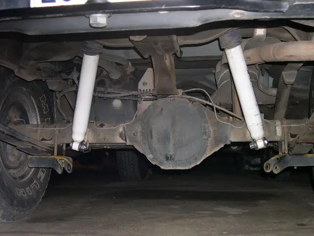

I started on my project today. But I didn't get very far. I welded up the shock mounts and I think they'll work well. But my shocks only have about 2 inches of travel left. I think I'm going to get stock size Bilsteins for the rear, and with the relocation of the mount it should match up perfectly. Here are some pics:

Looks Good man. Ebert has the same set up as me. tires and everything. I ran 30s with 3 inches and it looked cool, so 31s with 4 should be alright. Those mounts look good, though I will probably still do the more ones. what did they cost? Where did you get them? I am running no overload and no AAL. So I don't know how many springs are in there:rolleyes: . Lets see an after!! Another thing, mine had the adjustable camber bushings in it, that is why I didn't need the moogs, you might look and see if yours are adjustable.
Those mounts cost 3.50 a piece with the hardware. They are reallt well made, and for that price I figured it was worth it to get them. I got them from a local shop, www.foothilloffroad.com If you are running no overload and no aal, you should only have in 3 leaves. That's what I plan on doing. And if that is still too high, I'll fab up some shackles that are 4" or so eye to eye. I can do it myself and in about 15 minutes. As far as the camber goes, I do have adjustable shims in currently, and they have a ways to go before they are maxed out. So I think that I should be fine for camber. Thanks for the input, Kyle.
