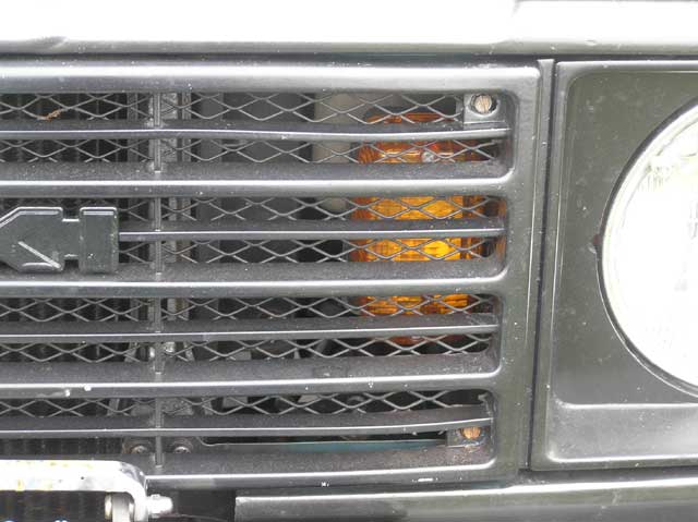

Also Draper how do you get away with not running any turn signals up front?

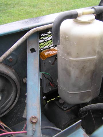

My turn signals are now behind the grille :D. I went out and bought 2 orange lights from the local autoparts store, fabbed up a couple angle brackets, and mounted them to the body behind the grille.

Draper, you ever get any crap from the cops with the blinkers like that? I'm sure in Ca they would get pissy over it. Is it Ca law that we have to have a front bumper????
Cops don't give me any problem with those lights here. We also have bumper laws in PA....just ask Lizard!! :confused:
It is CA law stating a front bumper is needed.
Of course.. I consider my zuk a trail zuk, which is why I really don't have a front bumper.
