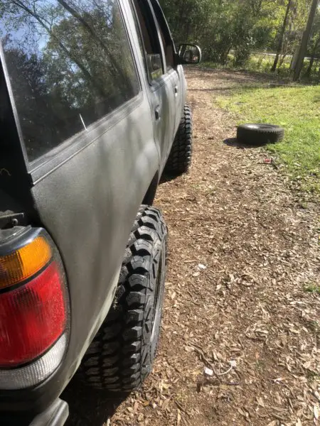

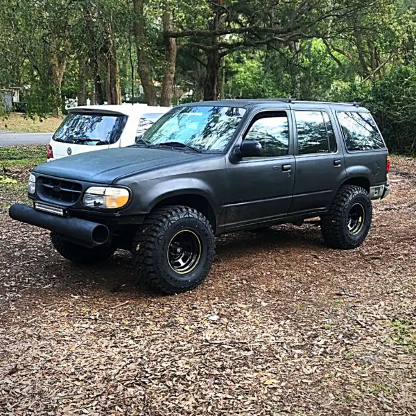

So I’m still riding on a maxed TT because I haven’t had time to install the parts in the front. I bought everything in the front end new, just need to install it all. I did install the springs and shackles in the rear.
So I picked up these 33/12.5/r15 for cheap, put them on these 10” wheels, all I did was cut away some fender and they fit! I did remove the inner fender also. This x didn’t have a bumper when I bought it.
Anyone here make their own inner fenders? Got pics?
Who’s got an idea for vacuum bulb relocation? I just shoved mine by the air filter.
Also, apparently the spindle lift I bought require 3.75” back space or less, so I bought some spacers, which I didn’t want to use but oh well.
