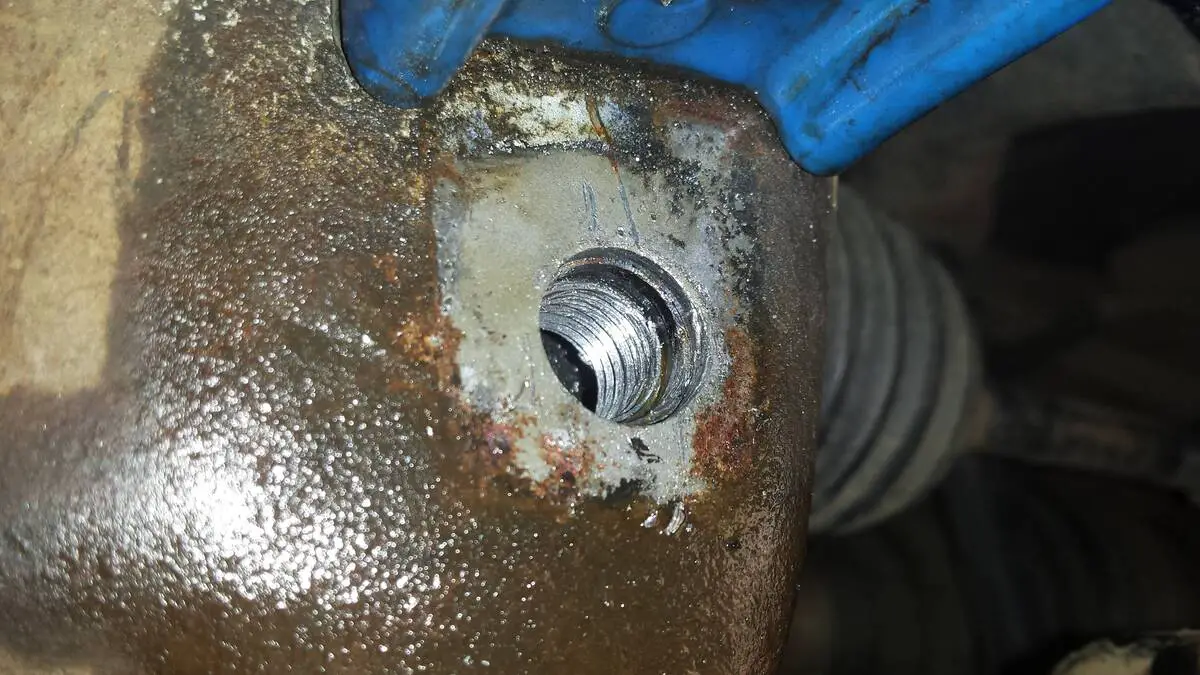

After thinking about things for a bit, I decided to re-tap the threads in the frame instead of putting a nut on the 7/16ths bolt. The reason I decided to do this is because having is a smaller bolt in the hole really does nothing, the upper bolt is still holding all the weight. I might as well have hot glued a toothpick in there and it would have been just as effective.
I went to Menards, yet again, and got a M12 x 1.75 tap and a tap wrench. I brought it and a can of PB Blast outside and went to town. And after an hour of work, here are the results!

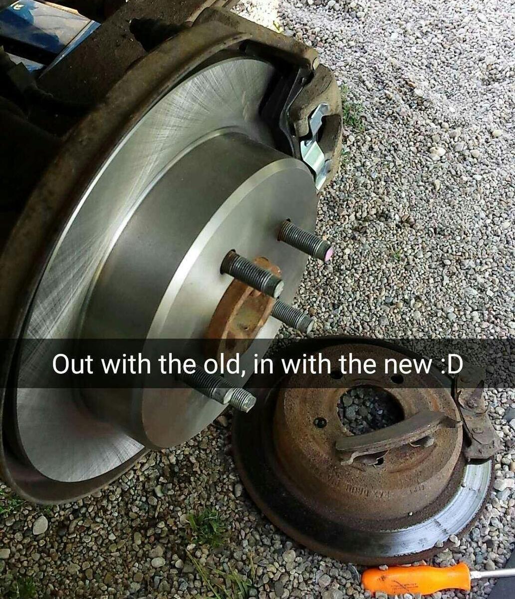

  • I replaced all 4 rotors and pads last weekend with a little assistance from my good friend PB Blast and a rubber mallet. Also got the new stud in, although a slight modification had to be done to it.
Here are some pictures:

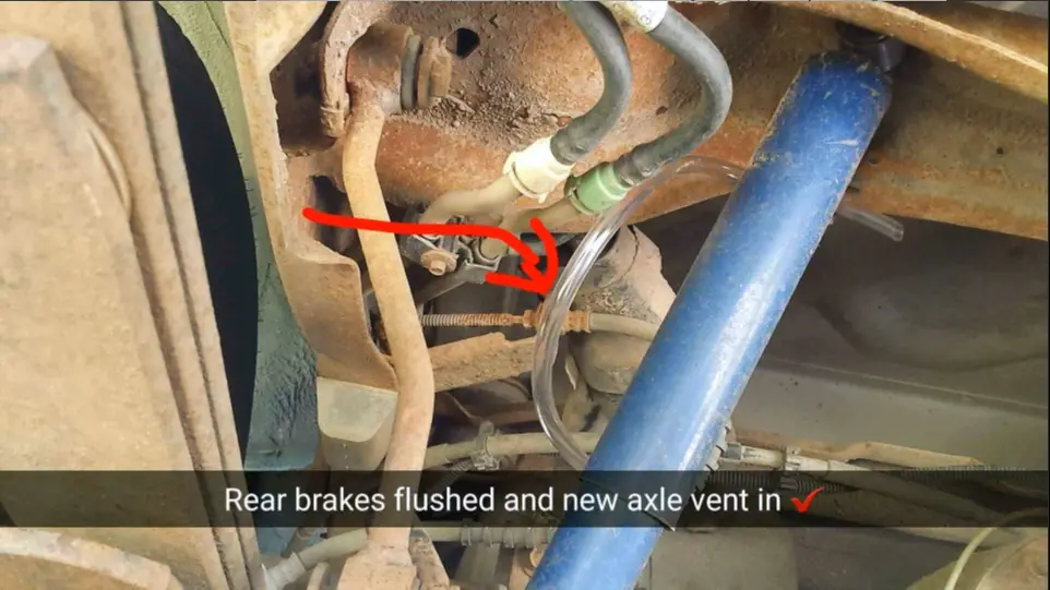

  • New caliper
  • Brakes flushed

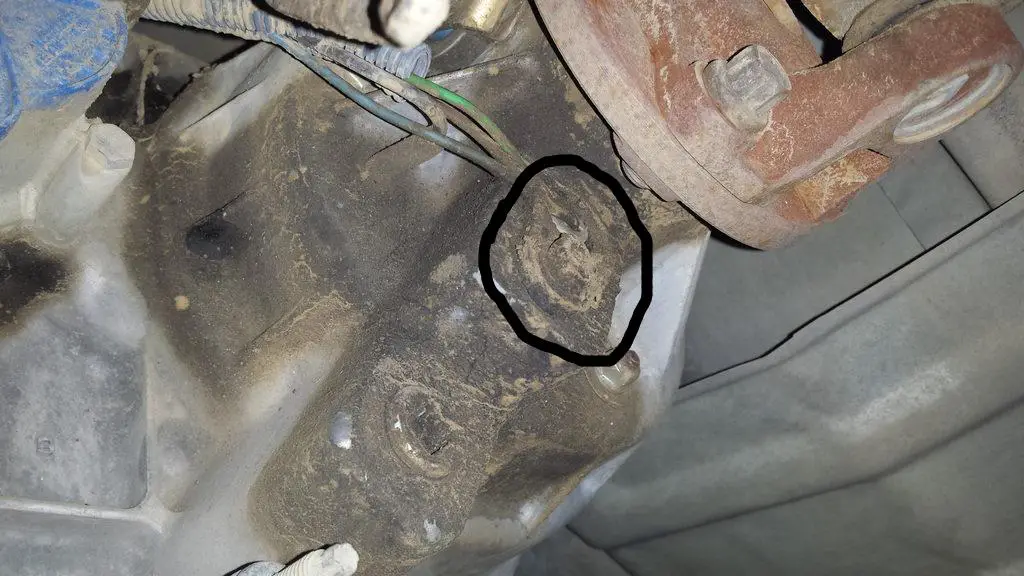

Here's the location of the rear hall sensor, you have to take off the skid plate to have decent access to it. It's a little greasy so I might have to clean things up and take new pictures if I make a guide.:D
EDIT: The part number for the rear sensor is SW5645.
