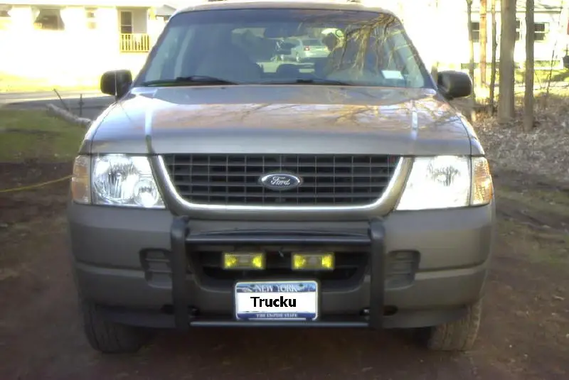

I got this smitty built from ebay for 100 delivered. Its not too huge to make my gas mileage suffer. It is frame mounted so you can push a car with no issues. It keeps the cars in the city from wanting to park right up agains my bumper.
I was able to slip in the backplate and then the nuts into the oval hole in the frame and use a srew driver to manipulate them. I didn't have to remove the bumper. I used an impact wrench to tighten the main bolts down while I used a screwdriver in the oval hole keeping the nut still. Once it took the washers squashed right down (80foot pounds).
I like that grill guard you got there..nice! :thumbsup:

haha thanx man
and yea im sure u would do some damage to a car who threatened u... that thing would have more pushing power than mine cuz its closer together
mine suprisingly doesnt weight too much but im sure it affects milage some
