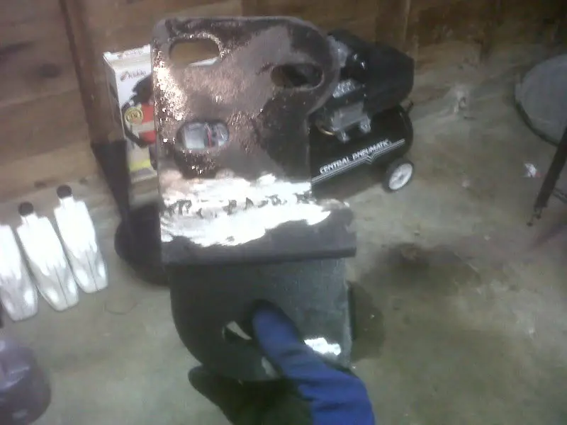

Hi, I have a quick question for the interwebs. I am looking to buy a go rhino 3000 grille guard. And I'm getting a 3" body lift (883) for sure. My question is what do I have to do to make the grille guard fit and look right with the body lift? I know I have to make new brackets, but how big and any other specs?? (And yes, I have already done many searches on this. Have not found my specific answer.:D ) Thanks!

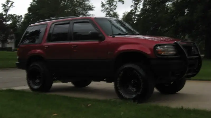

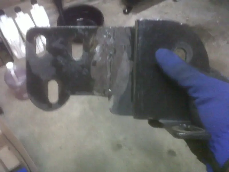

I got my brush guard off ebay and this is what I came up with. I just cut 3ins out of the stock mount and re-welded it.
Thanks. I was a little worried about how I was going to mount mine with the body lift. But I'm glad that it is possible. I'm hoping to get my lift by the end of this month, and the guard in a few weeks. So, I will see what I can do... Thanks for the pics as well.
