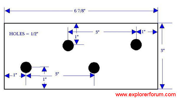

Templates for new bumper brackets.
Rear:
Front:
