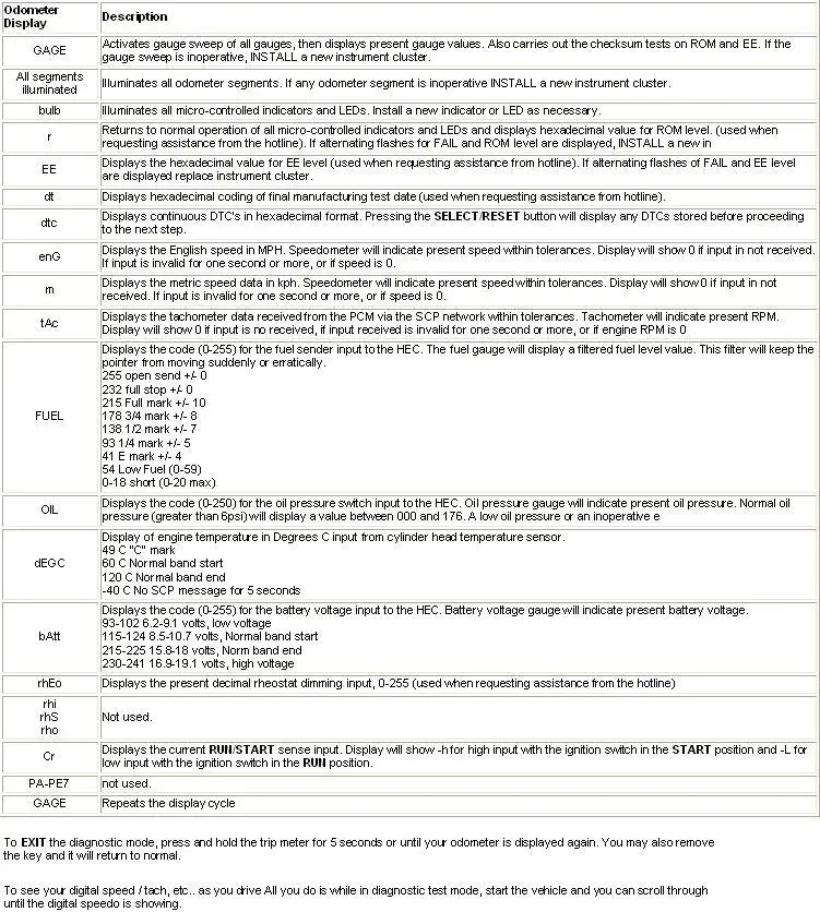

The instrument cluster has an intelligent module which communicates with the Powertrain Control Module and shows the data using its gauges and odometer/trip meter display. The cluster has a test mode for diagnostics use. You can do a gauge sweep to make sure the gauges are OK, and you can toggle to see the alternator voltage output.
Step 1
Insert Key (do not turn it)
Step 2
Press and hold the Trip-Meter Reset Button.
Step 3
While holding the reset button, start your car and continue holding the button.
Step 4
Within 10 seconds, the display should change to "test" (written in a silly LCD font) and the needles will go nuts. Release the Button.
Step 5
Pressing the button will now cycle through some 15 different modes or more.
Breakdown of some of the functions:
