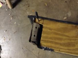

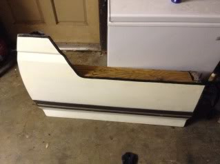

I did these on my 90 Bronco i started below the hole for the lock cylinder so i wouldnt have to do any hole filling and what i did with the latch mechanism so i could open them i found out which lever on the mechanism opened the do and connected a rod for the manual locks and when you push down the door would open

it was really simple to do i just made the cuts on the doors with a grinder with a cut off wheel.
i used masking tape to mark the line i wanted.
Once you cut the doors it will be very flimpsy atleast mine were cause i cut the top of mine off.
i would recomend pulling out the little thing in the door hinge that helps hold the door out bc it will make the door fling out cause of how light it will be.
i boxed mine in with some plywood even added speakers.
what i would recomend and what i did was put that stuff you line the edge of boat center consoles and things like that on the edge of the cut bc it will be very sharp.
unfortunatly mine bronco crapped the bed b4 i had a chance to put on mirriors but my plan was to take mirriors from a 95 f150 and put them on the tab that i left at the a pillar.
if i were doing it again i would design them exactly how i did bc its the easiest and imo is the best design out of any of them. basically mine are designed exactly like a jeeps halfdoors
sorry bud i never took pictures of them while i did them i still have them sitting in the garage but i cant take pics of the linkage cause the doors are all boxed in with plywood
